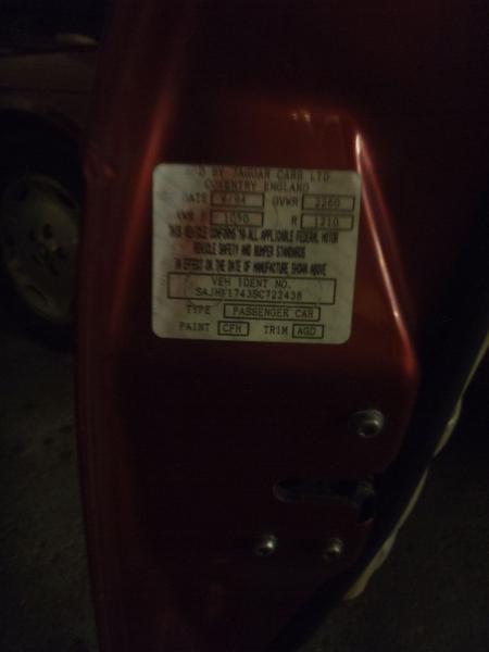

Old Jul 6, 2013 | 07:25 PM
Chris Craddock's Avatar
Posts: 69
It said on ebay that this is compatible with my car but I cant find it anywhere
I dont think its for my car at all.
thid id my vin number
Thanks alot
Attached Thumbnails Throttle position sensor-chris-craddock-137431-albums-94-jaguar-xj6-7478-picture-19164.jpg
Old Jul 6, 2013 | 11:03 PM
sparkenzap's Avatar
Joined: Nov 2007
Posts: 4,502
Likes: 1,068
From: atlanta ga
Ok, from the VIN, it looks like you have a X-300 manufactured early on, probably in 1994, BUT that is referred to as a MY 1995 in North America. The TPS for a X-300 looks like this and apparently the one in your picture is for a MY 91 through MY 94
