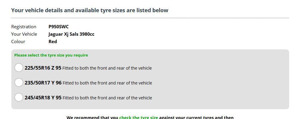

I put the my car registration into one of the online tyre places over here in the UK and it recommends:
Are there more options for you at 225/55 ? I've been using them for years and especially since I replaced the kaput steering rack it all feels fine.
The tyre firm offer me these:
https://www.blackcircles.com/order/t...loadratings=99
I'm curious how the range and prices compare in the USA
