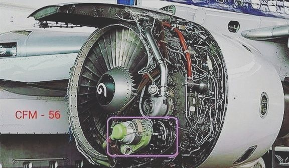

Too high voltage will cook the battery and shorten the service life . 14.8 V in my opinion is not a no go item but will cost you battery life not to mention possible electronics . Alternator should be removed from car to replace the regulator unless you are very crafty . The brushes and the rest of the Alternator is very robust but the one brush screw ( under the Z letter in the pic ) may be fused on ( no socket wall clearance ) so might as well order new brushes . When you get done rebuilding it you can take it to the auto parts store and they will spin it up before you install a possible bad out of stock regulator . Did that many times on airliners and they are very heavy on the back .
