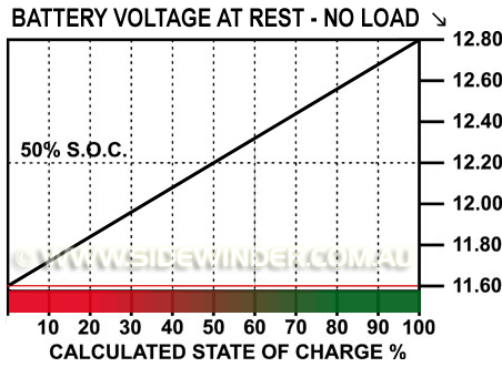

Not to split hairs here, but the chart for a traditional unsealed battery is different enough from that of an AGM or other sealed battery to matter. I believe Cambo's chart is for the traditional; the one I'm posting here is for the sealed battery. The voltage at 100% charge is about .20 volts higher, which changes the interpretation of any particular reading quite a bit.
Also there's a temperature effect. In really round numbers ... if it's around freezing, add .05 volts to your reading; around 0 degrees F., add .10 volts. This applies to both charts.
