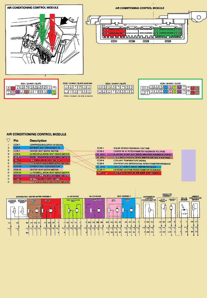

There is a self test on the control panel that will get you started on the path
See page 110
The fault codes are in a TSB
http://www.jagrepair.com/images/TSB/...stem%20DTC.pdf
http://www.jagrepair.com/images/Trai...des/703_SG.pdf

There are ways around parts if it comes to that
The self test does not " show " everything
