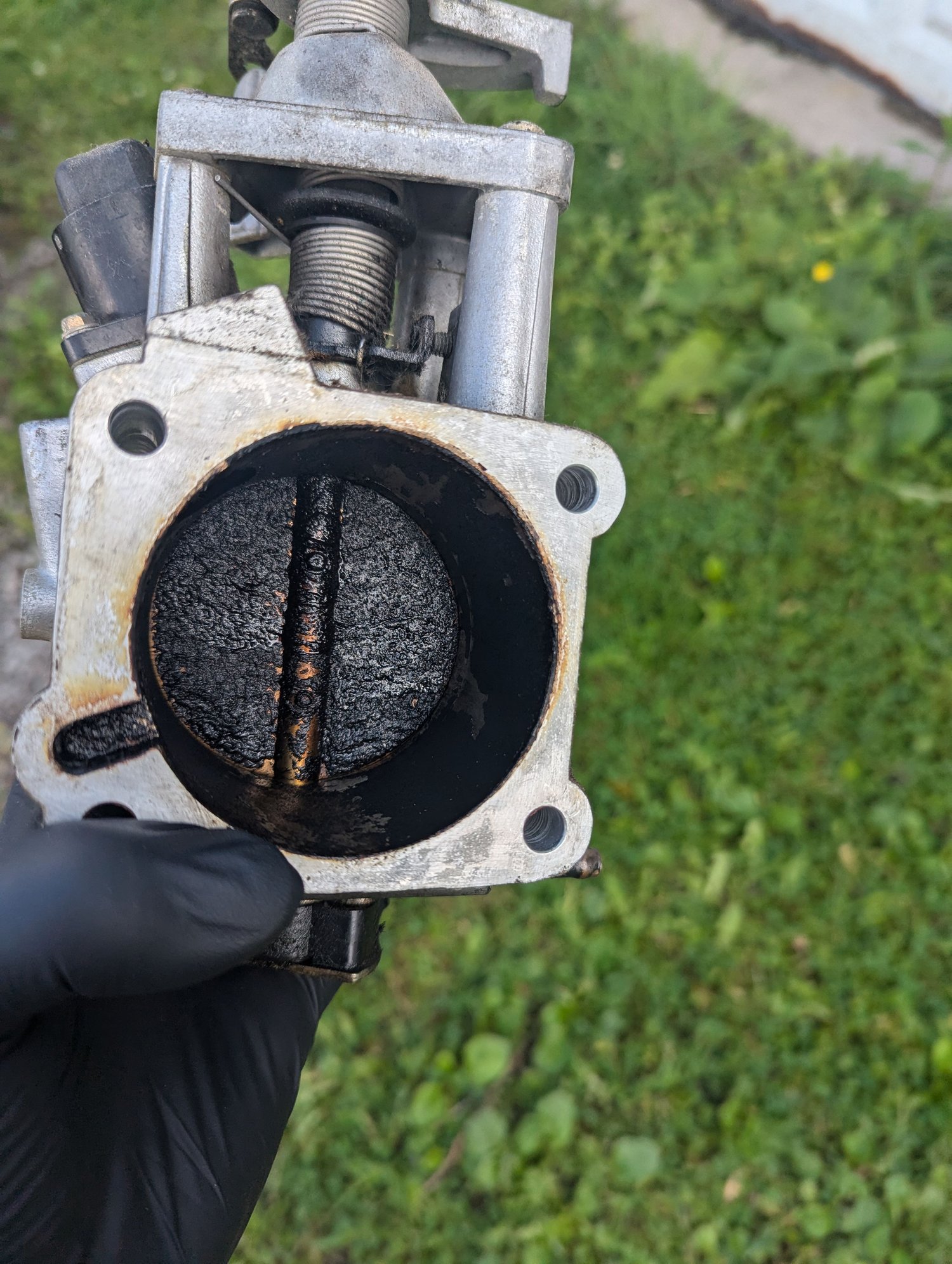

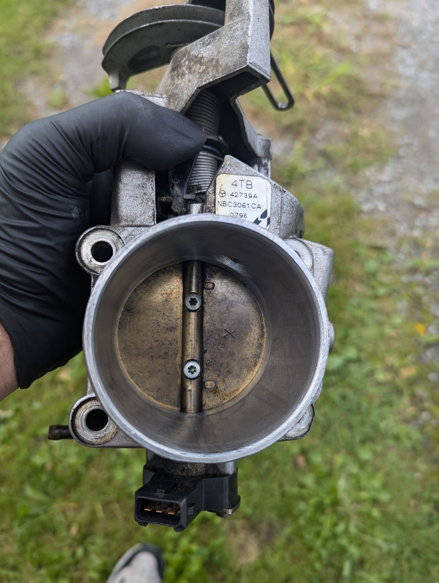

Default Throttle body clean
The car was running well but thought I would do some PM work before winter comes. So I cleaned the throttle body. Check out the before and afters.

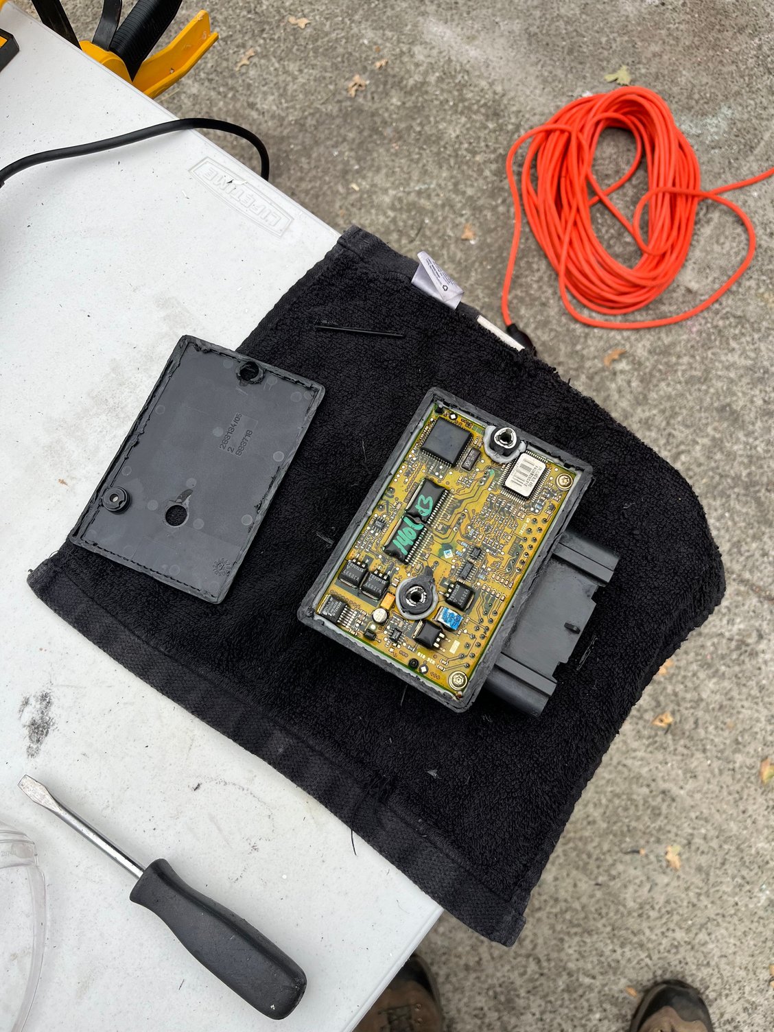

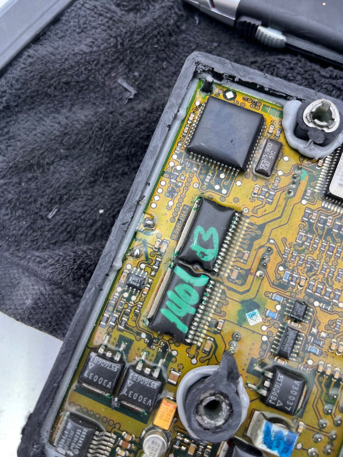

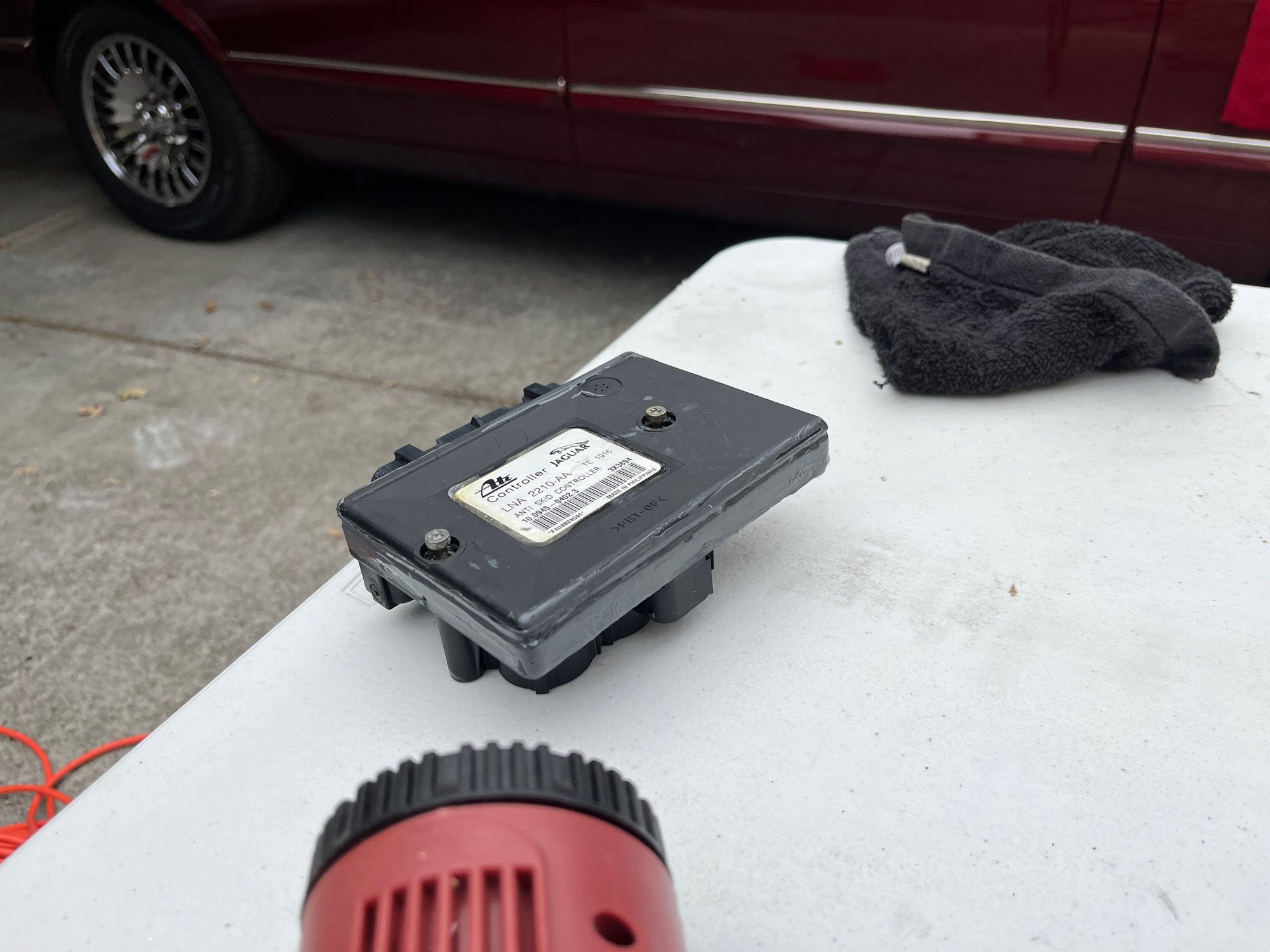

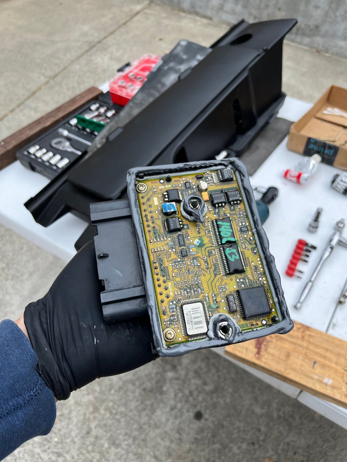

@SparkyGage your post made me smile.. My sons and I have a "Ruby" that we work on, too
Haven't posted anything in a while, but took it upon myself to re-solder the ABS module pins. Forgot how much fun it was to get at the t-20 torx screws on the underside... sheesh.
Module cut open, re-soldered, jb welded back together, and ABS light for Ruby Tuesday is off, hopefully for good.
Upcoming trip to Texas to do the on-site warranty service for my mom and Ruby Monday. Dad passed away a year ago, but he got to drive the car quite a bit before passing.
Cars that transcend generations mean something, these days. @Parker 7 you are always an inspiration.
ready to re-assemble w JB Weld
ready for the Dremel!
Top off... whew
re-soldered pins visible above the green-labeled computer chips. Had to scrape off the clear rubberish coating.
a little heat gun action to help the JB weld along
