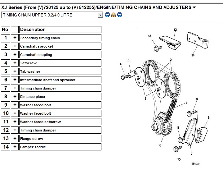

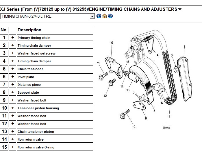

To add to Grant's excellent description, here's diagrams of the components from the Parts Catalogue:
1. Primary (Lower) Timing Chain:

2. Secondary (Upper) Timing Chain:
Click on the diagrams to enlarge them.
