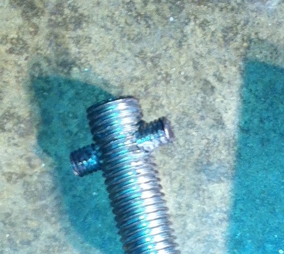

Sure, it's very easy.
You'll need to buy the following:
18" long hardened threaded rod, 3/4" to 7/8" diameter.
A 3/8" hardened rod or dowel pin cut down to about 1 1/4 - 1 5/16" length.
One or two hardened nuts for the large threaded rod.
Several large fender washers for the large rod.
Take the large threaded rod and drill a hole through it near one end that will allow you to insert the small rod/pin tightly. The result should look like this.
Grease the large rod well then insert it into the hole at the bottom of the spring pan all the way up to the slotted opening in the spring tower.
Then rotate the rod so that the pin at the end sits into the grooves inside the tower.
Now put the washers on the big rod under the spring pan and add the nut.
The assembly looks like this.
Now as you start tightening the nut, the spring pan will move up, compressing the spring. Once you have compressed the spring a good bit, place a jack under the steering knuckle (not touching the pan) and remove the bolts that hold the spring pan to the wishbone.
Now slowly start to unwind the nut. The pan will start to separate from the wishbone, the spring going with it. Eventually, when you unwind enough, the spring will be fully decompressed and you can remove the nut and slide it out.
Tip: Use the longest wrench you can or put pipe over your smaller wrench to give you more leverage as tightening the nut will be hard work! A ratcheting wrench makes life easier
