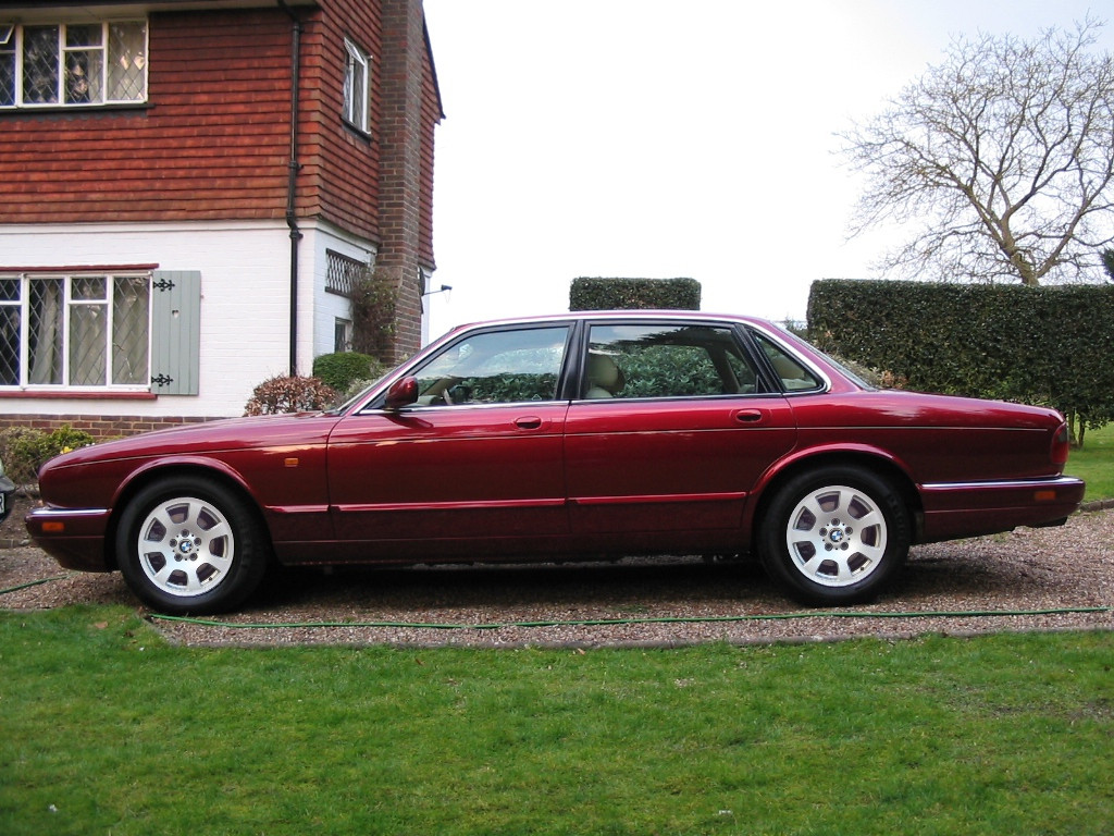

Originally Posted by socal1200r

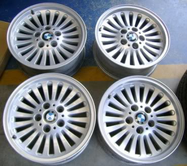

Another option that I've heard should work are the 5x120 wheels that are common on BMWs. 'Course the BMW logos would be removed!
These wheels would work, since they're 16x7, +20mm offset, with a 74mm hub opening:
I'd prefer these wheels (16x7, +20), but the hub opening is just a pube too small, at 72.56 (I believe the stock Jag ones are 73mm):

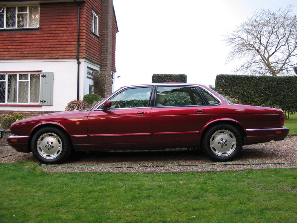

You could try getting a decent picture of the car and then photoshopping your wheels on it for a rough idea. eg, Felgen Katalog + X300 =
That last wheel you posted miiiiight look OK, but no improvement over the dimple IMO.

Old May 23, 2012 | 05:35 AM
Oubadah's Avatar
Joined: Apr 2010
Posts: 454
Likes: 70
From: NZ
I dunno what that other one you posted is.

Wow, me likee! The 5-spokes in the top pic are from an IROC Camaro, 16x8, with zero offset. I think the BMW wheels are 16x8, with a +20mm offset, so they won't stick out as far. I'm liking how those 5-spokes look, but my main concern would be that with the 0 offset, they'd stick too far out, and would hit the bottom of the fenders. I could probably get those IROC wheels for $100, so it might be worth the experiment.

FWIW, this one
Wait... That wasn't sarcasm?
I don't know what you guys are smoking, but I guess beauty is in the eye of the beholder.
Personally, I thought those BMW wheels matched better than expected. They certainly look better on the X300 than the cars they were designed for.

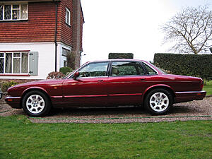

The bimmer wheels were also 16"s. I think my scaling was perhaps a little off. Original:
Not such great photoshopper. Maybe I should re-do... I was trying to find a bigger 'model' car image taken at a convenient angle (so that I didn't have to apply perspective effects to the wheels ), and with the car painted at least some roughly similar colour to the OP's car. But they were all small like the above.
Old May 24, 2012 | 02:15 AM
  #30
Oubadah's Avatar
Joined: Apr 2010
Posts: 454
Likes: 70
From: NZ

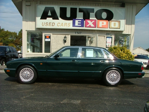

I did it again with better scaling, but I had to use the red car:
Again, pretty crude, but if you squint your eyes a bit they look alright.

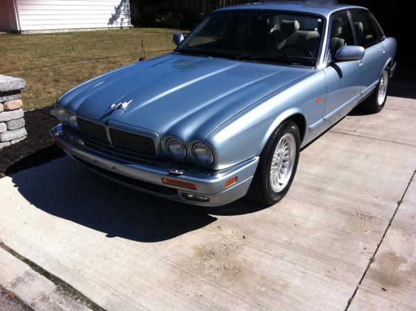

The photoshopped images look good, however, here it is in real-life form on my 95 XJR:

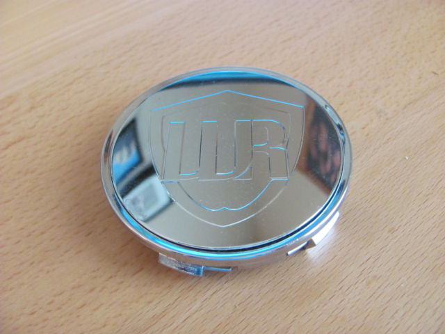

These are the centre caps that are on them right now but I'm looking to see if I can manipulate some cheap, Chinese bought, Jaguar ones from eBay to fit:
