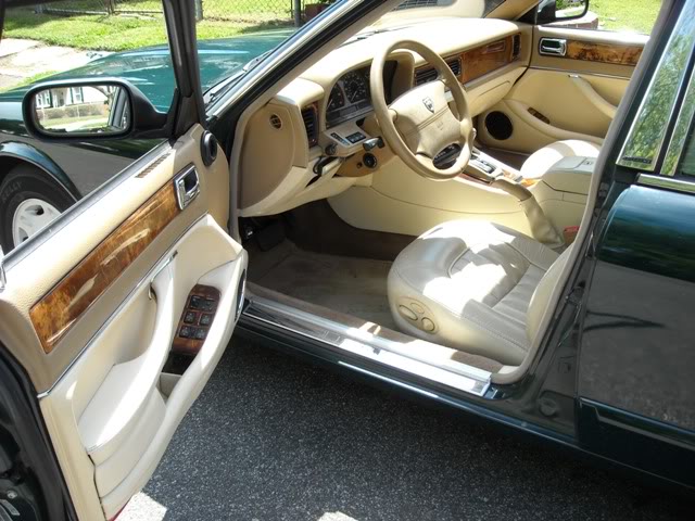

Just picked up a 1996 XJ6 with 92K miles yesterday, BRG with biscuit interior, for $3400. Clearcoat is shot on the roof, and lots of crowfeet on the hood, but a very solid car otherwise.

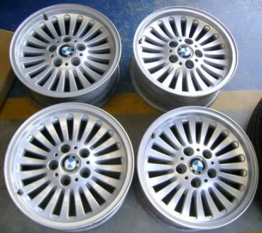

Put new tires on it, 225/60-16, and was wondering about swapping the wheels with some other make. From what I can tell, my stock Jag wheels are 16x7, 5x120 bolt pattern? BMW e38 wheels have the same bolt pattern (5x120), but not sure if the offset and backspacing is compatible.
Does anyone know if the e38 mesh-style wheels will work?

Folks over at the Saab forum (I have a '91 900 turbo convertible) chimed in with some opinions. Seems that there actually is a difference between the 5x120 (BMW) and 5x120.65 (Jag) wheels. Apparently, 5x120.65 is the same as 5x4.75", which is a typical Chevy bolt pattern. Only variables now are the offset and backspacing...
Old May 13, 2012 | 10:40 PM
Doug's Avatar
Posts: 25,538
Likes: 11,735
From: Pacific Northwest USA
....and center hole diameter. Jag hubs require a larger-than-typical center hole.

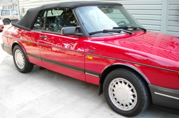

The wheels are kinda plain in my book, with a lot of aluminum there. Would like to get something where you can see what's behind 'em, and most XJ6 wheels that I've seen are more or less full face as well. I also have a '91 Saab turbo convertible, and swapped the stock 15-hole alloy wheels (which were a PITA to keep clean) with some later model "twisted" 3-spokes. I'm trying to stay away from multi-hole / multi-vaned wheels, which just traps brake dust and dirt, and take a while to clean.

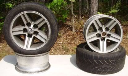

I was thinking of getting a set of IROC wheels like these, 16x8, zero offset, center bore opening 73mm (s/b same as the Jag's):
I think the center area of each of those spokes would look good painted green, to match the car. Subtle, but would tie in the color of the car with the wheels. Main issue is the zero offset 8" width would push the wheels out, maybe to the point where they'd bottom out on the fender lip, instead of clearing it like they do now.

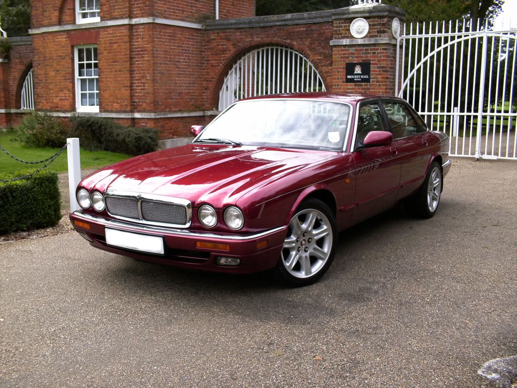

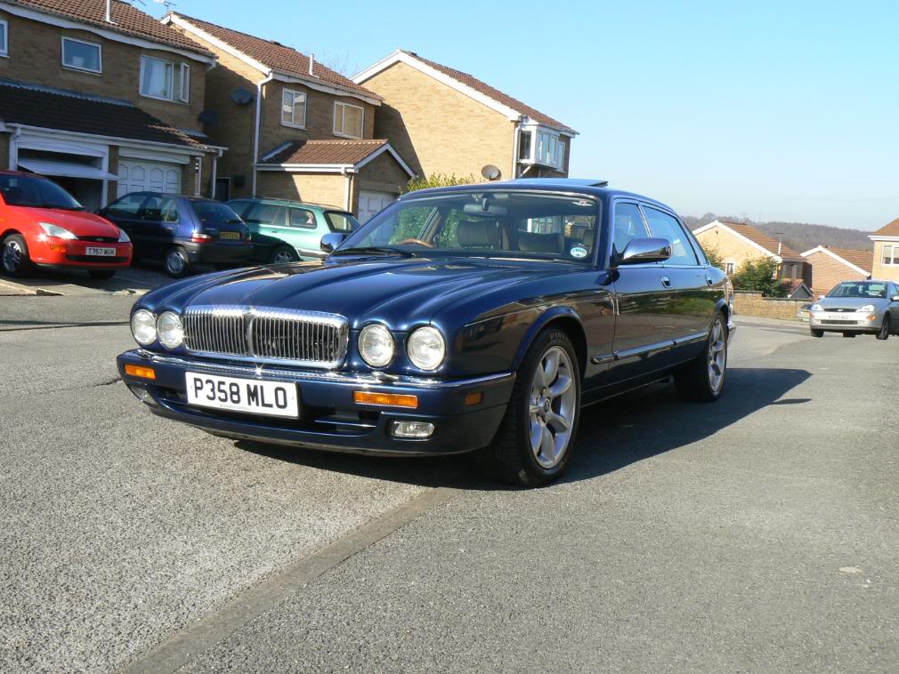

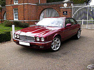

The only Jaguar XJ/XK V8 wheels I know of that will fit the X300 are the X308 VDP with hub caps. The others will need to be modified in some way because of the front hubs.
bob gauff
Panchostatus has that combo, maybe he can tell us.

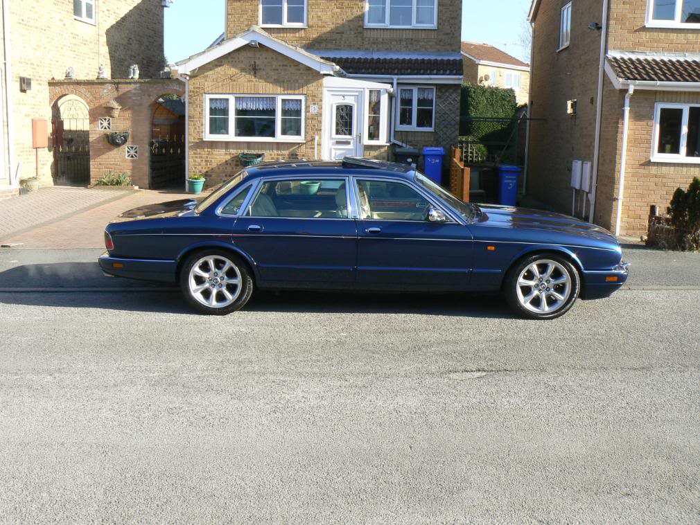

Here is another X305 with that wheel:
Look damn good, huh?

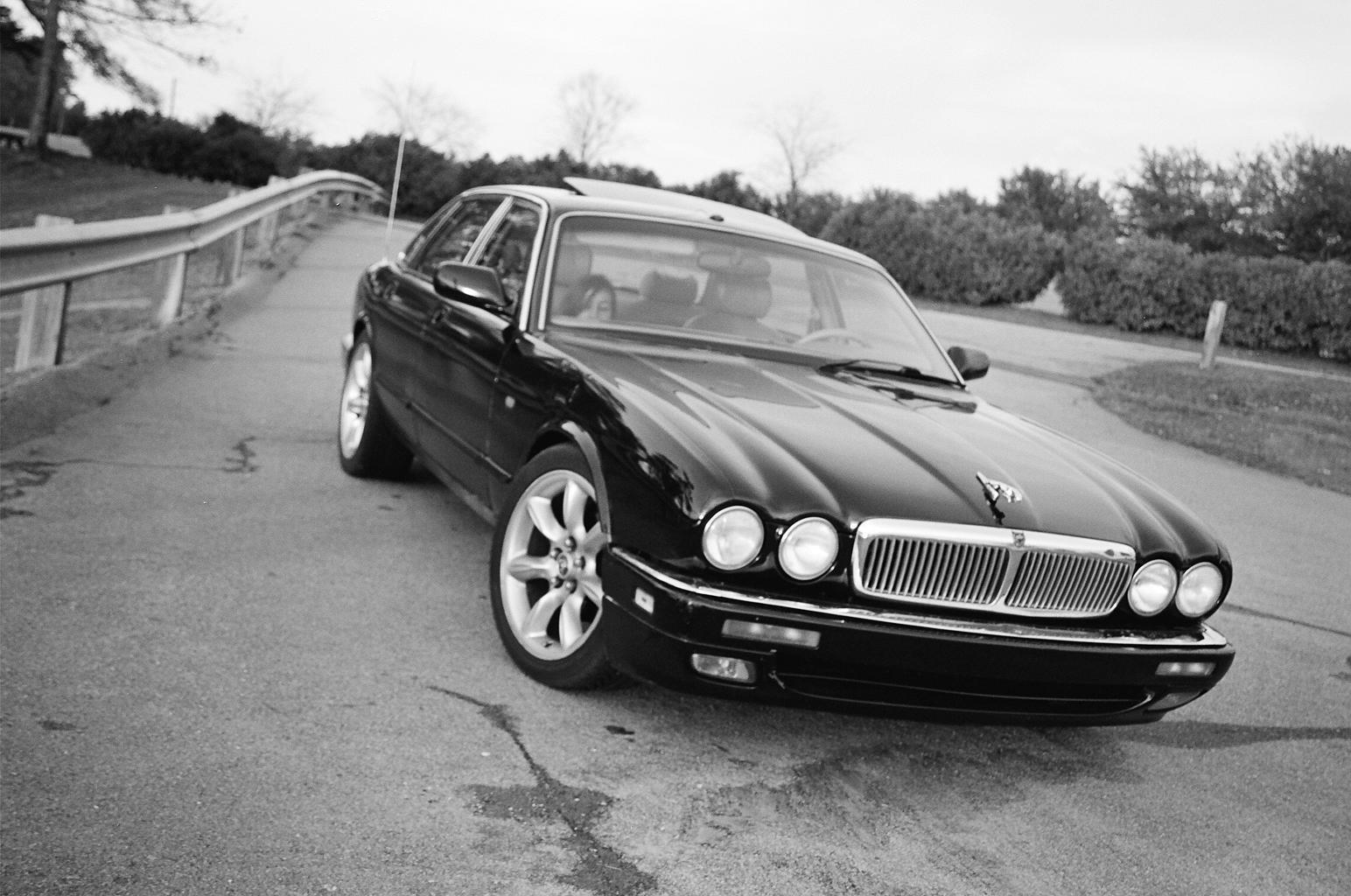

There is also another, somewhat similar, XKR wheel that looks pretty good on the X300:
