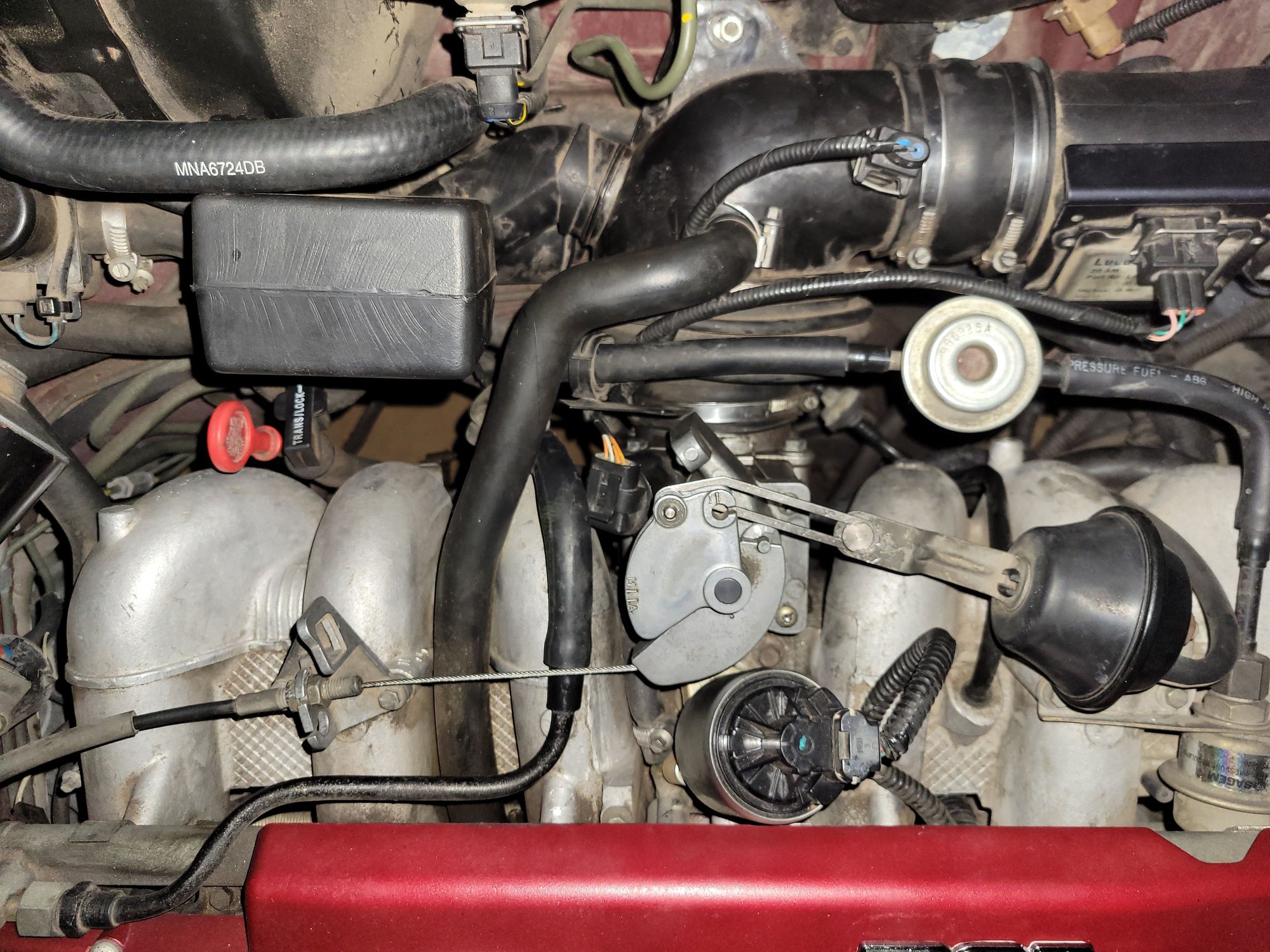

Here's a photo of the cruise control linkage on mine, which is working normally.
Cruise Control to Throttle Body linkage

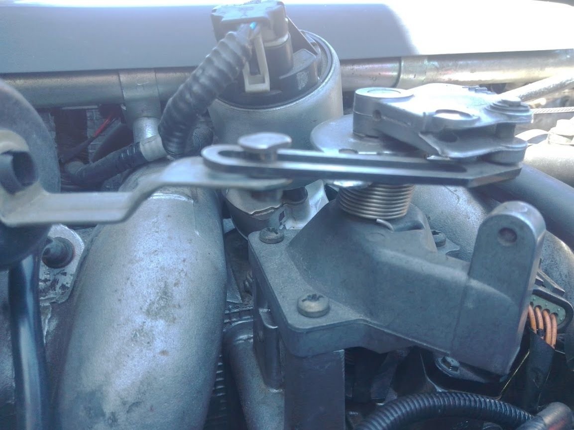

Here is mine so I think everything looks correct. I took a bigger view just in case someone see something

The cruise control connections look ok from up there. The two arms should have a loose connection, with a good gap. There's also a washer on the nut.
It all looks like its hooked up as it should be from what I can see.
