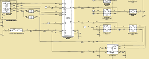

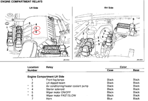

Low speed and intermittent functions to not work. The low speed sometimes moves very slowly and the intermittent does not move at all. When on low speed, and I put my hand on the motor, I cannot feel any movement in the motor. On high speed you can feel the motor rotating.
Is this a different problem than the gear slipping, perhaps caused by the switch or a relay?

Yes , there is separate relay and switch contact for low
swap the fog relay
