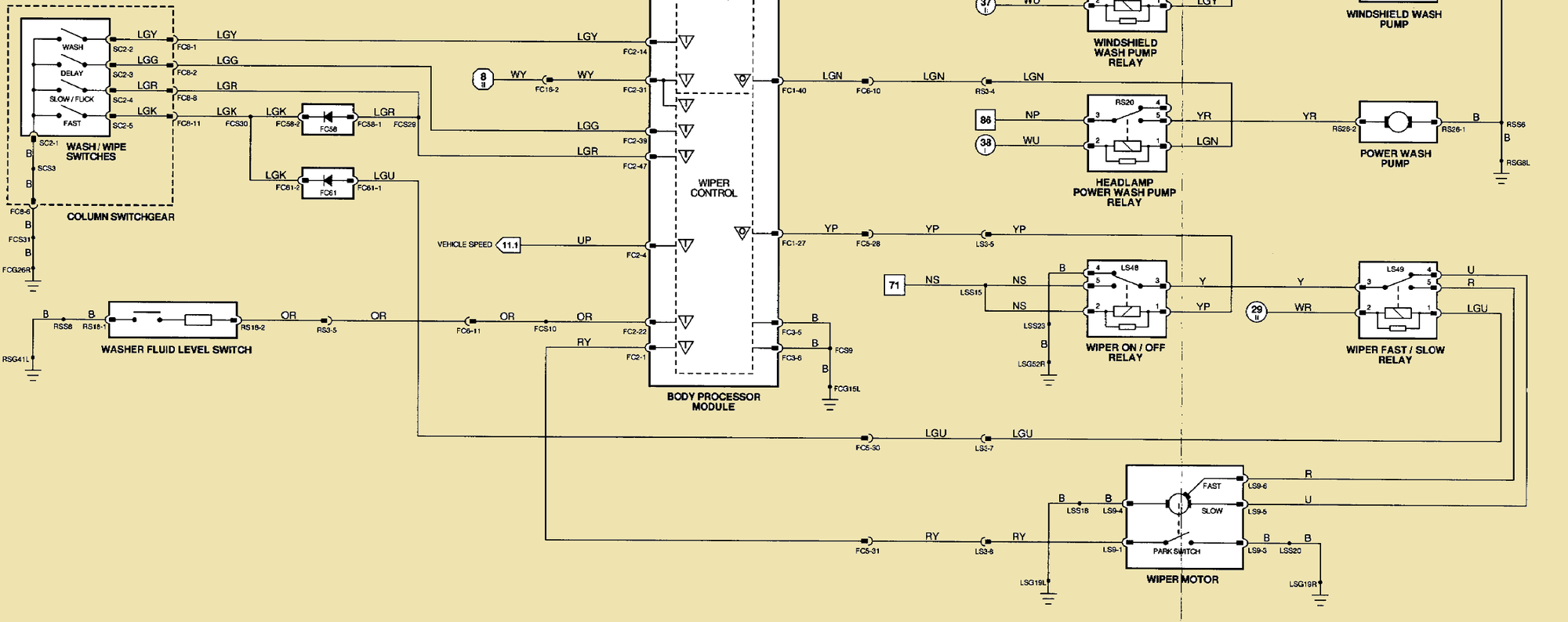

this must be an issue in the switch mechanisim?
if it was fuse then nothing would work as only 1 fuse.
could it be relay?
Have not got a chance to
check wiring diagram to see exactly how the relays work until i get home

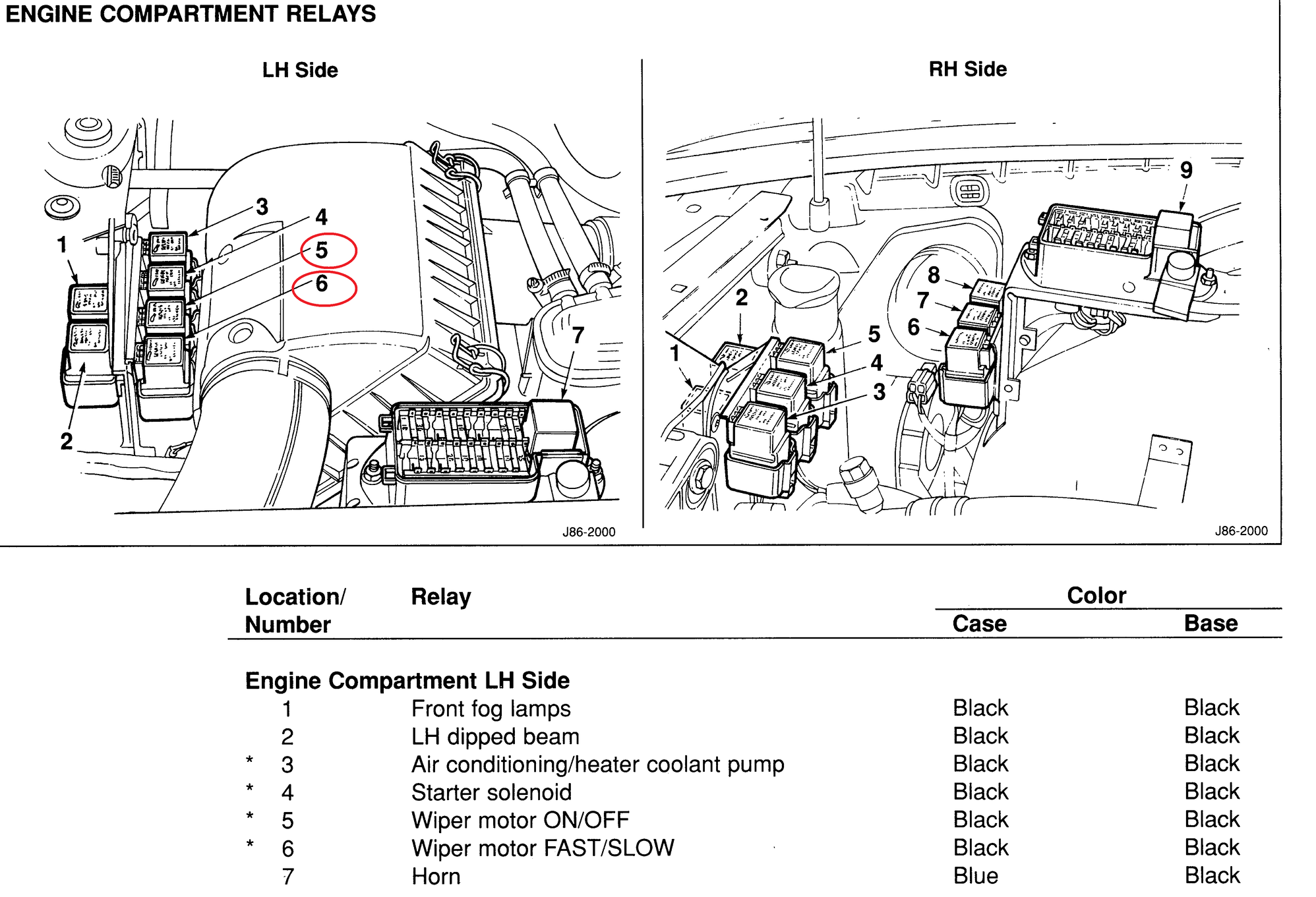

Remove/check the wiper SPEED relay behind the headlamp.
I've seen this enough time at the dealer to recommend investigating the relay.

The easiest and first try is 2 wiper relays that you can swapped with other then each other , I would target # 6

The slow / fast relay has a fuse # !6 / 10 amp right heelboard fuse box which relies on the fuse box relay staying closed
This is the same fuse box relay that must stay closed to keep fuse # 10 / 5 amp right heelboard fuse box powered which is the control half of your fuel pump relay
notice the engine correlation ?
You can have a floating relay
in all fuse boxes fuse 10 , 12 , 14 , and 16 must have the fuse box relay closed
fuse 1 - 9 and the rest bypass this fuse box relay and are directly wired inside the fuse box to the battery

thanks for the info....
but fortunately it was the easy option.
it is the wiper relay.
swapped out a known working relay to test.
all functions worked.
now i guess i need to go buy a relay unfortunately don't have any spares atm.
