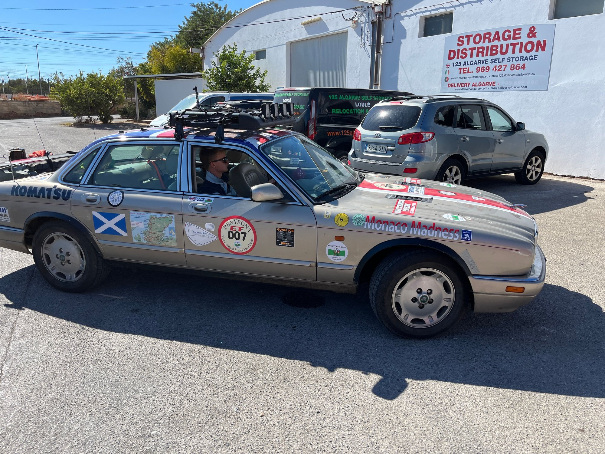

Rusty my well traveled x300 has developed a fault during her winter rest. Was perfect when parked up three months ago now won’t rev passed 1200rpm. Starts and idylls perfectly but as rev builds it’s like she floods herself with fuel. Any ideas appreciated, I’ve tried what I can think of.

I thought about it over a cup of tea. It had to be something affecting whole engine, not just one cylinder as if just one cylinder engine would still be able to rev. It was faulty when hot or cold, so couldn’t be O2 sensors as they are out the equation when cold. It wasn’t the MAF sensor as that was working. Only other thing could be crankshaft sensor! Took it out, replaced for a spare I have had for years and hay presto she was fixed

A silly little broken CKPS is not gonna keep Rusty down for long! Nice work, Stu, go for the #1 easy things first. I think I should drink more tea.
