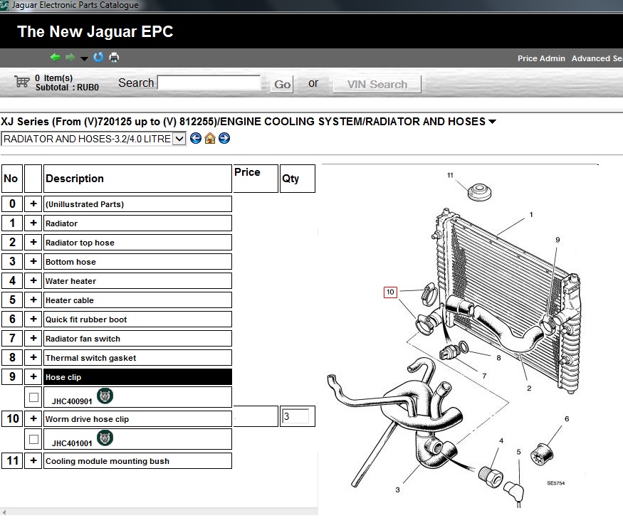

Jaguar EPC is the definitive guide. Items 9 and 10 - Worm Drive Hose Clips:
Clearly visible in the diagram. Print it off and take it along to the next heated debate. They were confusing the X300 with the later X308 setup which does use spring clips.

The parts list calls for three of number 10 and one of number 9. In the diagram I only see two number 10 clamps. The number 9 clip, as drawn, looks like the third number 10 clamp.
So where is the third number 10 clamp?

At the top end of hose, part #3
