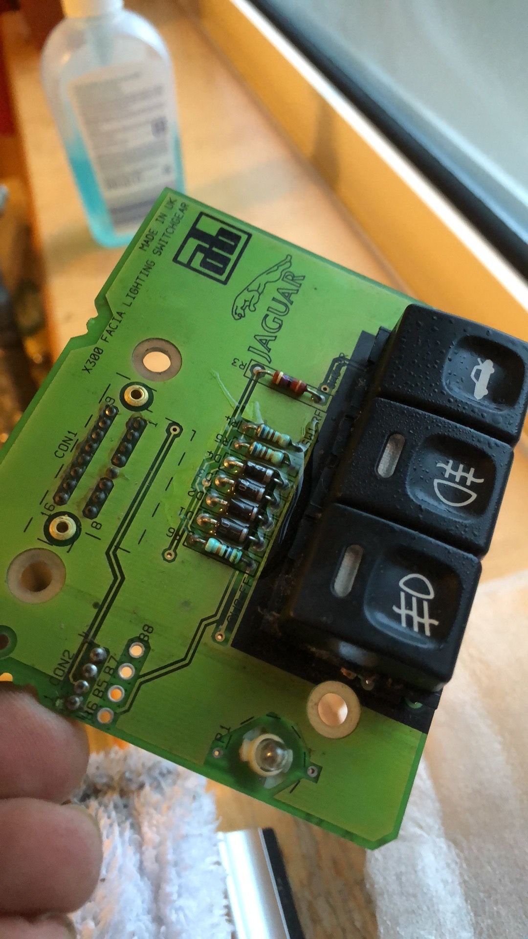

Left my lights on side light only all night and this morning all lights had come on so I suspected that the little light next to the switch warmed up and then something on the board expanded and made contact !!
removed board and wiggled the plugs and nope then tapped the resistors above the fog light switches with my finger and hey presto ,a loose resistor 👌🏻
heated it up to flow solder and then covered the resistor wires in epoxy and hey presto all sorted ,you guys are genia ❤️
