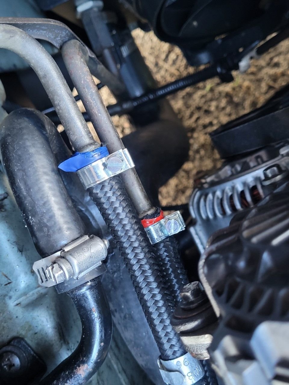

Just a follow up. The issue was the transmission cooling lines. I forgot that many models have cooling lines for the engine as well. My apologies. As for the broken cooling lines, the break was in one of the rubber sections of the two lines. We were able to replace the rubber hoses on both lines with "6AN" 3/8" industrial rated line and better quality hose clamps from Amazon. A single 10" section was enough. I moved the original part number tags over as well for no particular reason. Photo included here.
Thanks to all that helped!
