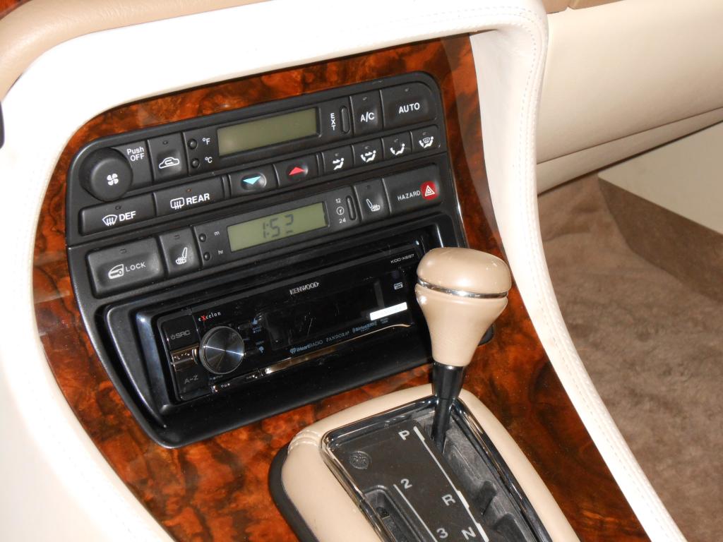

That looks great! Is that a cassette player? I had no idea anyone still made them. Except for the Kenwood logo it looks factory. Nicely done.

No cassette, cd, blue tooth, usb port front and rear (and goes to glove box)
Going to try and make a decal to put over Kenwood name

That looks fantastic! Did you do it yourself or have a shop do it?

Got:
Autoleads PC2-55-4 - Jaguar Sovereign, XJ6, XK8, XKR, XJ-V8, XJ12 Wiring Harness
Autoleads FP-14-00 - Jaguar XJ6, XJ12, Sovereign upto 1997 Fascia Trim Panel
and radio off amazon
Soldered Kenwood plug to jaguar plug (Very simple)
Watched video on you tube on removing radio (very simple)
So just went ahead and did it myself
would recommend it to everyone
