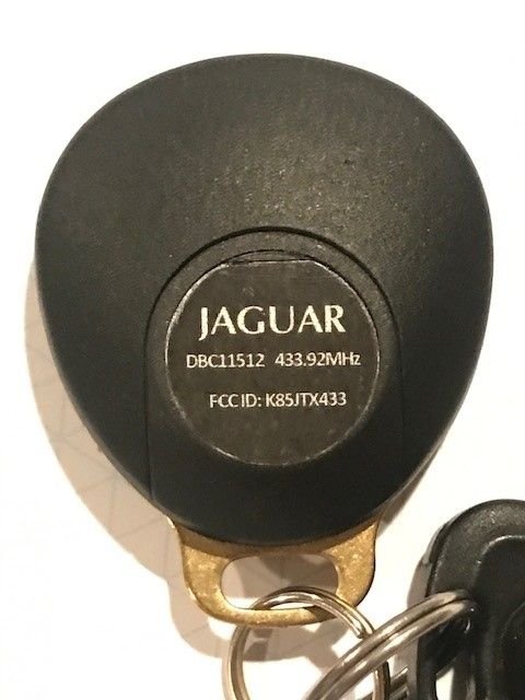

The key fob door lock transmitter on these cars has a label on the battery cover that notes the frequency and a FCC identification number. I attached a picture of a replica I made to replace the lost label on mine. I copied the text from a X300 fob with the label intact. This is the question:
Is the frequency and FCC data the same for all of these devices for this series of cars? It's just a minor detail that doesn't matter much; I'd just like to be correct if I'm going to duplicate the label.

There was 2 frequencies during X 300 production
You have an example of the later Freq
See TSB below

Oh, I see. I have that TSB; didn't think to look at it. Do you think the earlier 315MHz cars change only those digits in the label data? Does anyone have a fob with the 315MHz frequency? Are the rest of the characters the same?

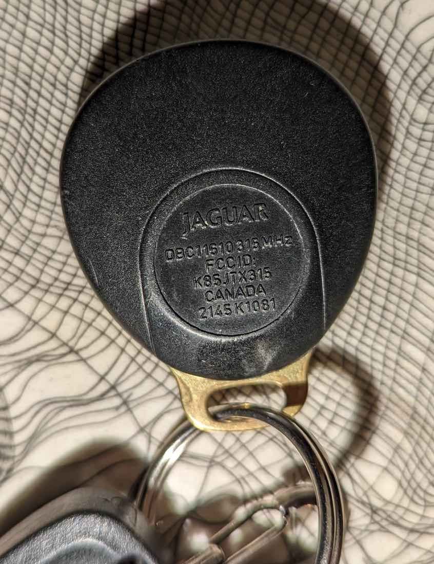

Old Oct 18, 2022 | 08:39 AM

John, very nice. Thanks. It looks like they were more sure of what to do with the early cars; the numbers molded into the cover. Is your car Canadian or do you think the Canadian number is on all the North American cars?
Niles

The FOBs manufacture has to do with the Government's regulations
For example, without knowing the details an Canadian 315 can have a frequency bleed over of 5 % but a American is only allowed a bleed of 1 %
So the American must be manufactured and tested with tighter tolerances
So you would expect different Jaguar part #s
See item # 6

From a manufacturing perspective, the smart thing would be to build and test to the tighter US requirement which will of course satisfy the Canadian requirement. Then it's not necessary to differentiate the devices, and the labeling can be as shown on the sample above. Perhaps logic prevailed on this minor aspect of the car.
When the 433MHz device began to be used, the marking was an adhesive set label, a duplication of which is shown further up in this thread. Likely a production expedient that allowed the same cover to be use for all versions. Easier to localize the text as well.

Ah. In the link posted by Parker 7 I can only two part numbers buried in all the applications. DBC11510 for the 315MHz device and DBC11512 for the 433MHz device, irrespective of the locality. Excepting Japan and Hong Kong with an entirely different part number. I'll go with the notion that all the devices satisfy the most stringent requirements and it was less costly and provided better utility to remove the text insert from the mold and replace it with a frequency and locality specific adhesive label.
