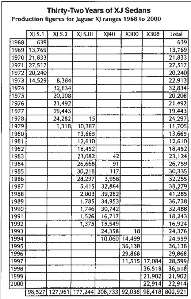

this forum is for the old XJ-6 from 1968 thru 1987. You car is a model X300, totally different cat than here. Try the X300 forum for help.
Attached Thumbnails XJ6 turns over, starts but cuts out after 2 seconds-xj-prod-chart.jpg
