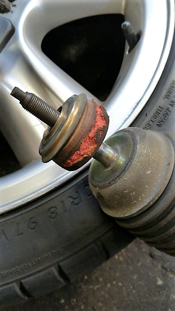

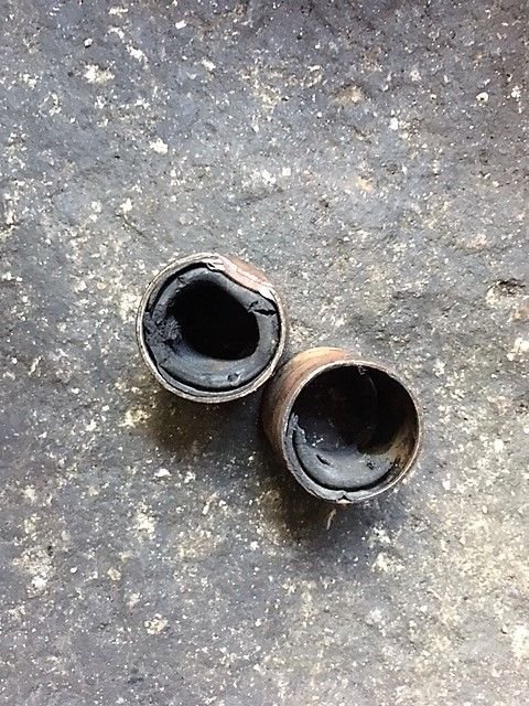

Incidentally I am fixing my front suspension system as well. I had genuine Jaguar insulation pad (Item 8) on the first diagram of Lady P's Post above (and see picture below),
but these factory pads while doing their job to ensure a quality ride, do not last as long as one would have liked, although longer than average after-market products. The mechanic knows some more durable ones which I am trying on.
As for other bushings, yes stay with factory originals if you can still find them. I have decided to go for Powerflex Purple and Black as it is easier to find a full set (and they have good diagrams showing you which is which) rather than hunting down on individual factory bushings as one or two are no longer available or you would have to go to different sources to find a full set. British Parts has the full set as well but those bushings do not last very long (9 months?). See pictures.
