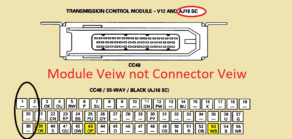

On the GM 4L80E transmission there are 2 electric shift solenoids giving 4 shifting possibilities as that based on percentages is probably what it is . You can read them from the Transmission ECU as pin 53 to 39 ( Solenoid A ) and pin 53 to 43 ( Solenoid B ) . But may not see them as a failed circuit until they are heated up as this is a solenoids primary mode of failure ( if it is that ) . But if you can see them cold it would be worth a try as a least intrusive try . I don't have the GM L80E transmission so it is an outside observation from the same issue I had on the GM 4T65E series I had .Shift Solenoid Pattern :

Look for CEL code P0755 through P0759
