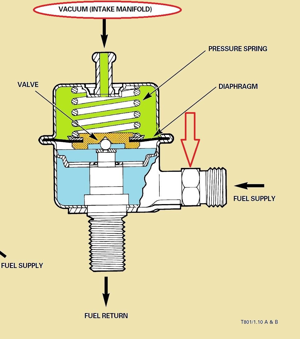

Can you pull the little hose off the FPR and see if it looks wet or smells of fuel? If it does, you’ve most certainly found your culprit.
​​​​​​….if it doesn’t, still doesn’t confirm it’s working well.

Cheers mate, yup pulled the hose and was dry, but FPR looks pretty old. When the engine runs from cold, even after closed loop, its fine. But at some point it starts over fueling. Then floods.

The fuel pressure regulator if regulating to bypass over pressure amount will give a sound and hum
the regulated pressure is 43 psi at idle and the pump should put out more than that , the bypassed fuel will recirculate to the tank on rubber hose X
Fittings are hard to find to get pressure reading
It's a rubber diaphragm so won't last forever but a diaphragm should leak into the upper small vacuum hose into the intake manifold causing cylinders to be over rich

The vac hose will change the fuel pressure regulated by the spring inside from base 43 to 47 when vac applied , throttled up engine drawing vac
This is normal already accounted for by the ECU controlling injectors bandwidth ( open time / squirts )
With a leaking vac hose it will under fuel in theory and not develope full power
