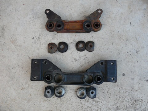

The rear anti roll bar makes a significant change.
I once attached one onto my sovereign and I was totally impressed how it improved the handling of the car.
Even with a combo with a normal diameter front bar, it works great.
But trouble is that you also have to change the wishbone tie, which is a part behind the diff tying the diff and the lower arms.
To change it is a PITA, plus it is a bit hard to find.
Ref the pic attached, the upper one is a normal one and the one below is the one to attach the anti roll bar.

Japthug, thanks for the warning. Yikes, I just ordered the XJR rear sway bar parts from Jaguar Heaven so I have inquired about the extra parts re the wishbone. As far as the PITA part, would a normal mechanic be able to handle it easily?
I ask, because if this becomes enough of a combined expense I would rather stop and switch my resources to the PowerLock LSD with the 4.09 rear axle ratio.

Yes it would, I think it will be 2-3 hour labor and with a lift and transmission jack it will be an easy job.
If you get parts from Jaguar Heaven, they can get parts according to the parts number, so you can specify the parts by the parts number.
wishbone tie: MMB2855AA or MNA2855BD
X308s have the same mechanism but the wishbone tie has smaller holes (2 inner holes out of 4 ones) where it attached to the diff bolts, so the tie has to be X300's or early X100's.
If you want to use X308 wishbone tie, you also have to change the diff bolts, which will really be a hard job because loctite locks the bolt so hard.

You will definitely change the wishbone tie to attach the rear anti roll bar if your car is not a sports or an R.
You could have the mechanic take the photos of the wishbone tie so you can visibly check.
During that procedure you need to unlink the tie and the strut, so it will be cheaper to change the strut and the tie at the same time.
