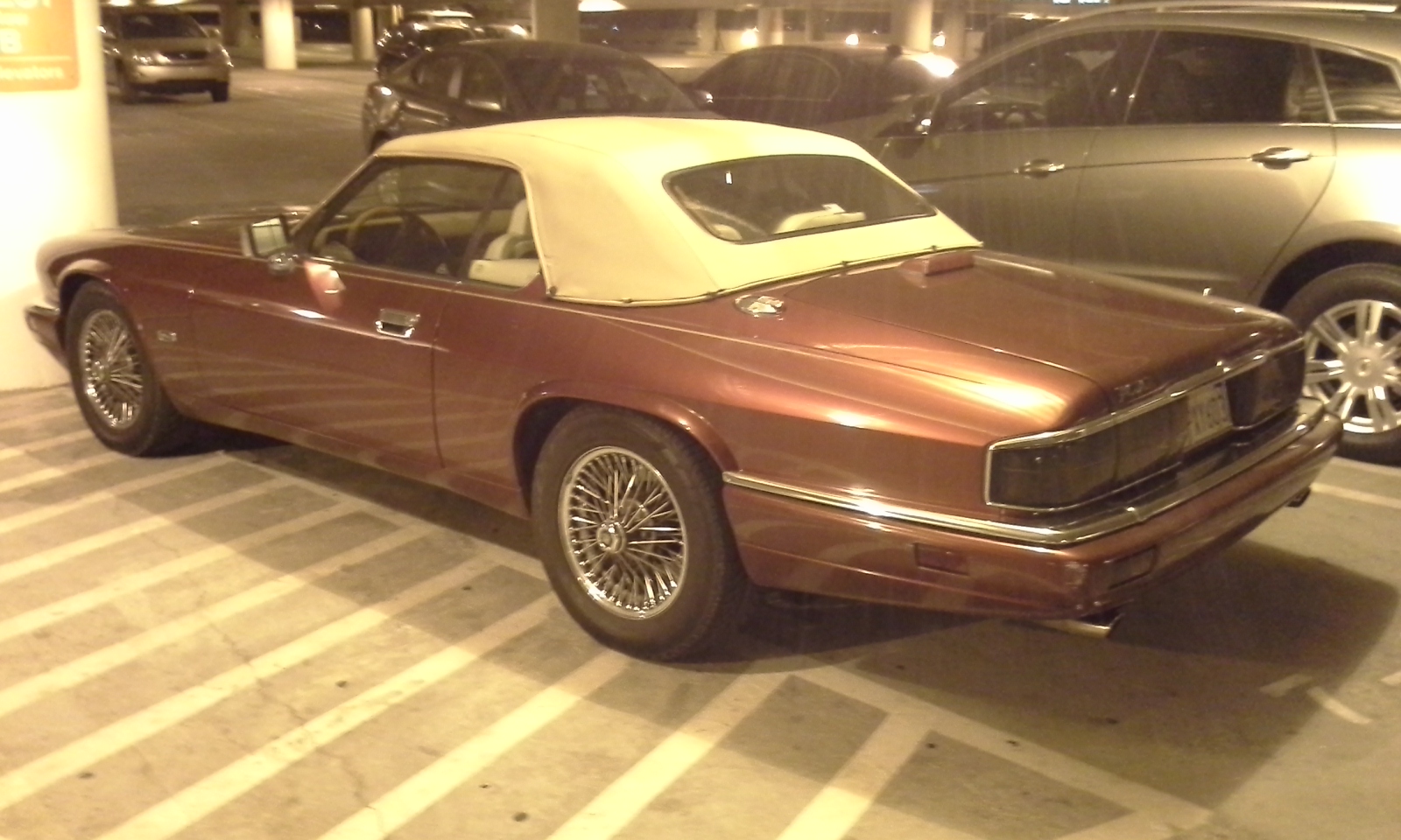

Is there a name for the person that waits by a special car for the owner, or maybe places a note on the car, to inquire about it? I was close to doing just that when I saw this 96 a few months ago. I had to at least take a picture of it!
I too, aspire to XJS ownership one day. 94-96. Possibly even a V12. Hard to decide between coupe and convertible. Who knows what the future holds?
