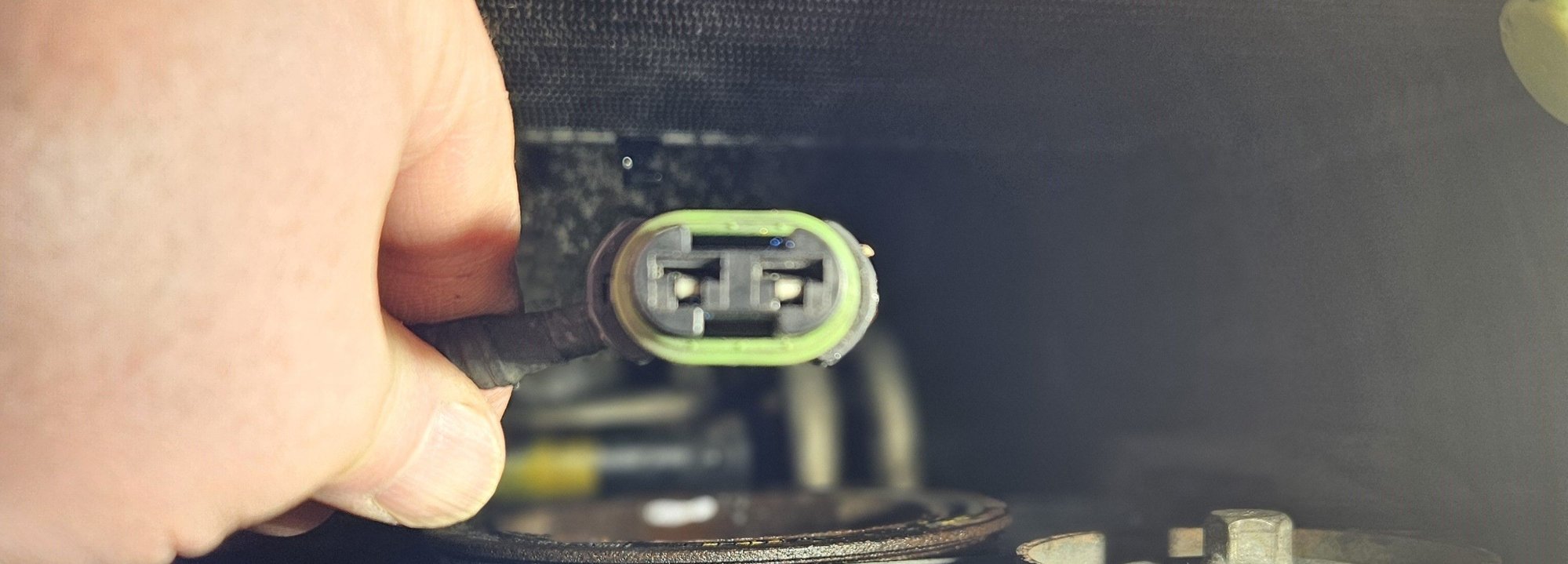

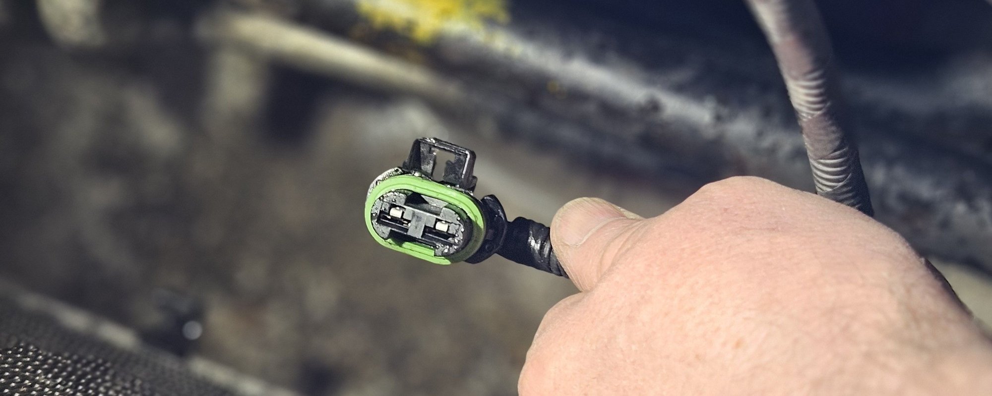

Also, I managed to break off the locking tab on the right side electric fan connector while doing the water pump. Anyone know the correct part I should get to fix this?
This is what it looks like now, still fits in securely but it could fall out without a latching thing.
Here's the one for the left side fan, still intact.

Man those plugs are tough to find mainly because there are so many variations. Don't know if this will help but I have spent hours trying to match up plugs. It's most likely a Motorcraft connector from the days when Ford owned Jaguar.

On Page 18 of the X300 guide it shows that connector as
Econoseal 3 HC

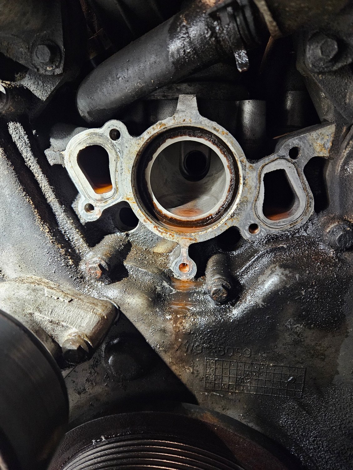

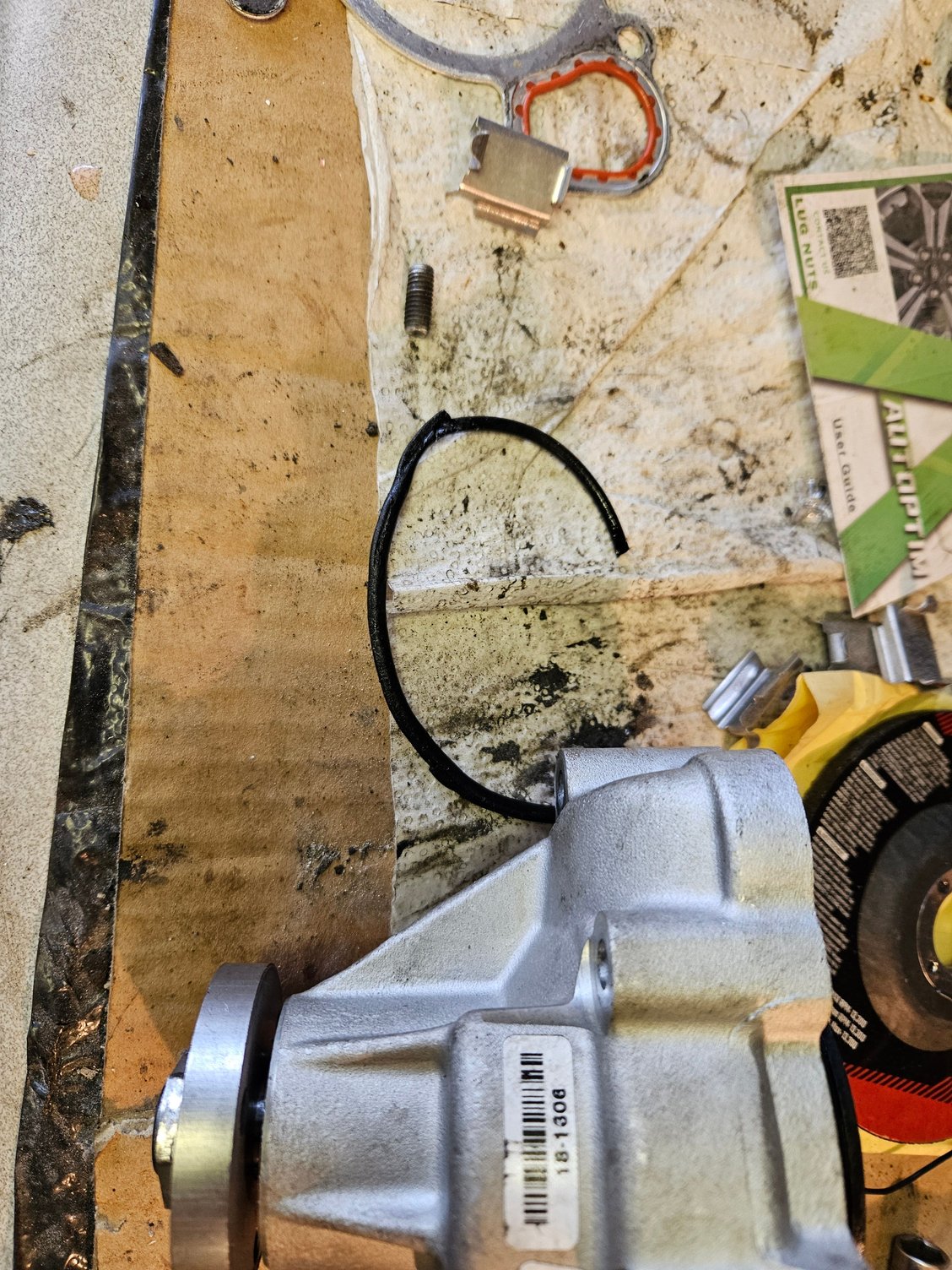

This is the o-ring that came out with the Delco pump. I presume it was original to the old pump.
This was after the Delco pump came out. That crud seems very hard, a pick scrape didn't do much to it so I toweled it "clean" and installed the new pump. Maybe I need to do a better job on this?

I know this is a little bit late but, you can use some extra fine steel wool on those surfaces to clean them up also. Brake cleaner on a clean rag following is advised prior to reassembly.

Pulled the pulley off last night to see if there was any obvious leakage, saw none. So my plan is tonight I'll try to clean up the front of the engine from the years of grease/oil/coolant and whatever else gathers under the hood, remove the cooling fans and reconnect the serpentine belt to run all the accessories, get it up on ramps with a fan blowing on the radiator and just wait for coolant to start accumulating and see if I can follow it to a source. I wouldn't be surprised if something started to give out when the temp gauge redlined as I did have steam at the front of the engine at that time...its seems less likely to me that it might be accumulated spillage, but I can't rule it out I suppose...with the cooling system I think a bit of overcaution is preferable. I don't have a lot accumulating on the floor, it seems to be almost all evaporating...hoping its not a line under the supercharger or the radiator.
