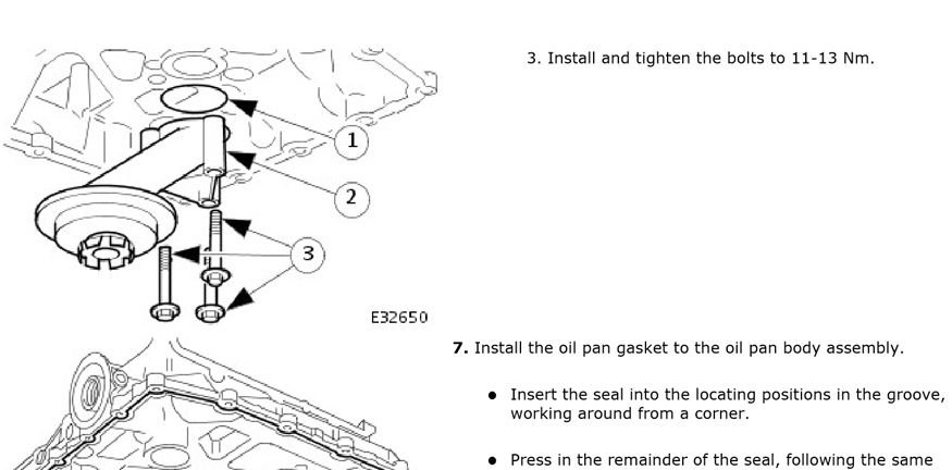

Would you know the torque specs for the pickup tube????
Old Apr 10, 2020 | 01:14 PM
  #249
Carnival Kid's Avatar
Joined: Jan 2018
Posts: 1,841
Likes: 1,018
From: Redding CA
That's 8-9.5 ftlbs to you and me.

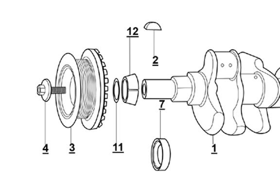

Good morning guys and gals...
I want to install the harmonic balancer back on , from what I read the tool that was installed to hold the flywheel for timing has to be removed 1st.
Some have used a bolt or pry bar to hold the flywheel. . I kinda get that but from where ?
Is that Thu the access hole that had the rubber stop in it right by the hole for the tool ?
thanks
Old Apr 11, 2020 | 10:09 AM
  #254
Joined: Jan 2018
Posts: 1,841
Likes: 1,018
From: Redding CA
Definitely remove the crank positioning tool from the flywheel, and you need to remove the two camshaft locating bars too.
To install the harmonic balancer, liberally lubricate the crank seal, then simply align the harmonic balancer with the keyway, push it into position (don't forget the very thin rubber "O" ring that goes inside the harmonic balancer) then install the crank bolt, when ready to fully tighten the crank bolt (to it's massive 275ftlbs) simply use the same large crankshaft holding tool that you used to undo the crank bolt.

Gm CK
[QUOTE=Carnival Kid;2216783]Definitely remove the crank positioning tool from the flywheel, and you can remove the two camshaft locating bars too.
That's done ,cam covers back on oil pan back on.
What keyway? O-ring replaced and oiled. I now have a 3/4 " torque wrench.
what about making sure the crankshaft doesn't move? Thought that was a big deal and why people are using pry bars or bolts to hold the flywheel ? Or am I just misreading it?
Old Apr 11, 2020 | 10:39 AM
  #256
Joined: Jan 2018
Posts: 1,841
Likes: 1,018
From: Redding CA
Originally Posted by Carnival Kid
What keyway?
The keyway in the crankshaft that aligns the harmonic balancer on the crankshaft............item #2 in this diagram.
I now have a 3/4 " torque wrench. what about making sure the crankshaft doesn't move?
That's what the large crank holding tool that you have is for, it holds the harmonic balancer, which is keyed to the crankshaft, while you tighten the crank bolt to 275ftlbs.

I dont have a key-way or a slot for a key-way ??
I have the tool....
So confused !
And stop SYH....!
going back to garage to make sure ... pretty sure no keyway.. But ive been wrong before...
Old Apr 11, 2020 | 11:13 AM
  #258
Mrjay622's Avatar
Joined: Jul 2019
Posts: 398
Likes: 13
From: Piffard Ny
Ok i checked..
I used the mirror and a pick just in case it got sheared off and I couldn't see it... I'm pretty sure there's no key way or ever was.
I thought it was held on by the friction of that ring that compression ring
Old Apr 11, 2020 | 11:18 AM
  #259
Highhorse's Avatar
Joined: Feb 2013
Posts: 4,936
Likes: 1,928
Look at your harmonic balancer piece 12 in CK's detail, you should have a slot in the crank insert hole where the key would align. Its easy for the key to fall out with cam alignment being its underneath.
Old Apr 11, 2020 | 11:21 AM
  #260
Joined: Jan 2018
Posts: 1,841
Likes: 1,018
From: Redding CA
MrJ, hmmm, maybe I am confusing the key for locating the crankshaft timing gears, and maybe there is no keyway for the harmonic balancer? But usually balancers are specifically aligned, not allowed to be randomly placed in any position.
But now I think of it, the harmonic balancer has a tapered cone which would not allow for a keyway or woodruff key.
Difficult going from memory without the actual car/parts in front of me.
Sorry for the confusion..................but you do need to remove the alignment tools, and use the large crank holding tool to hold the crank while tightening the crank bolt. Basically the harmonic balancer is held by the large holding tool while the crankshaft is "pulled" towards the crank bolt and gripped by the tapered collar.
275ftlbs is A LOT of torque, you will need a socket wrench with a 6ft extension, and pull for all you are worth to get 275ft lbs.
