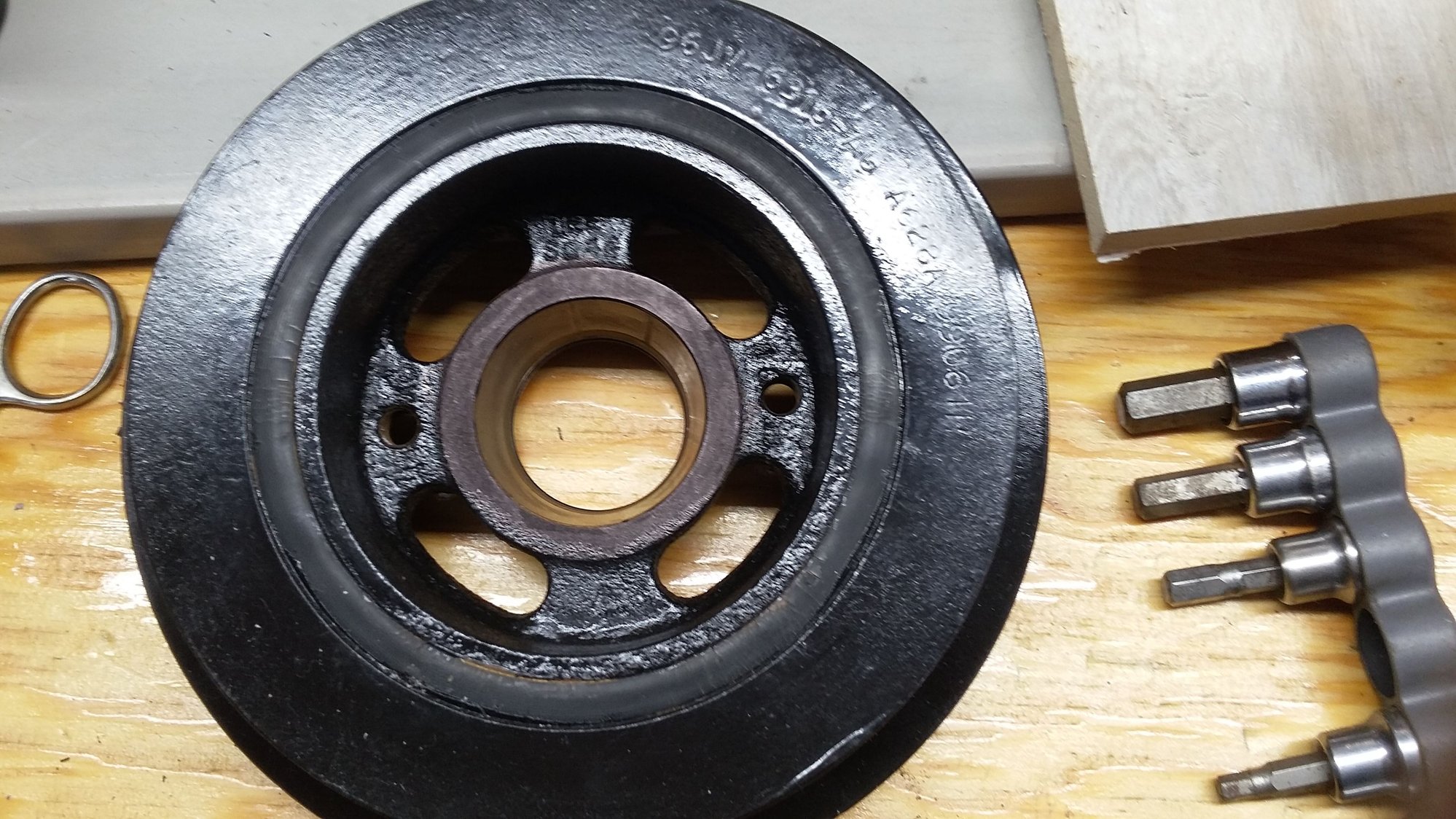

See...lol. I'm not completely out of my mind....

I may need to revisit because mine being a SC, it may be different?
Old Apr 11, 2020 | 11:31 AM
  #263
Highhorse's Avatar
Joined: Feb 2013
Posts: 4,936
Likes: 1,928

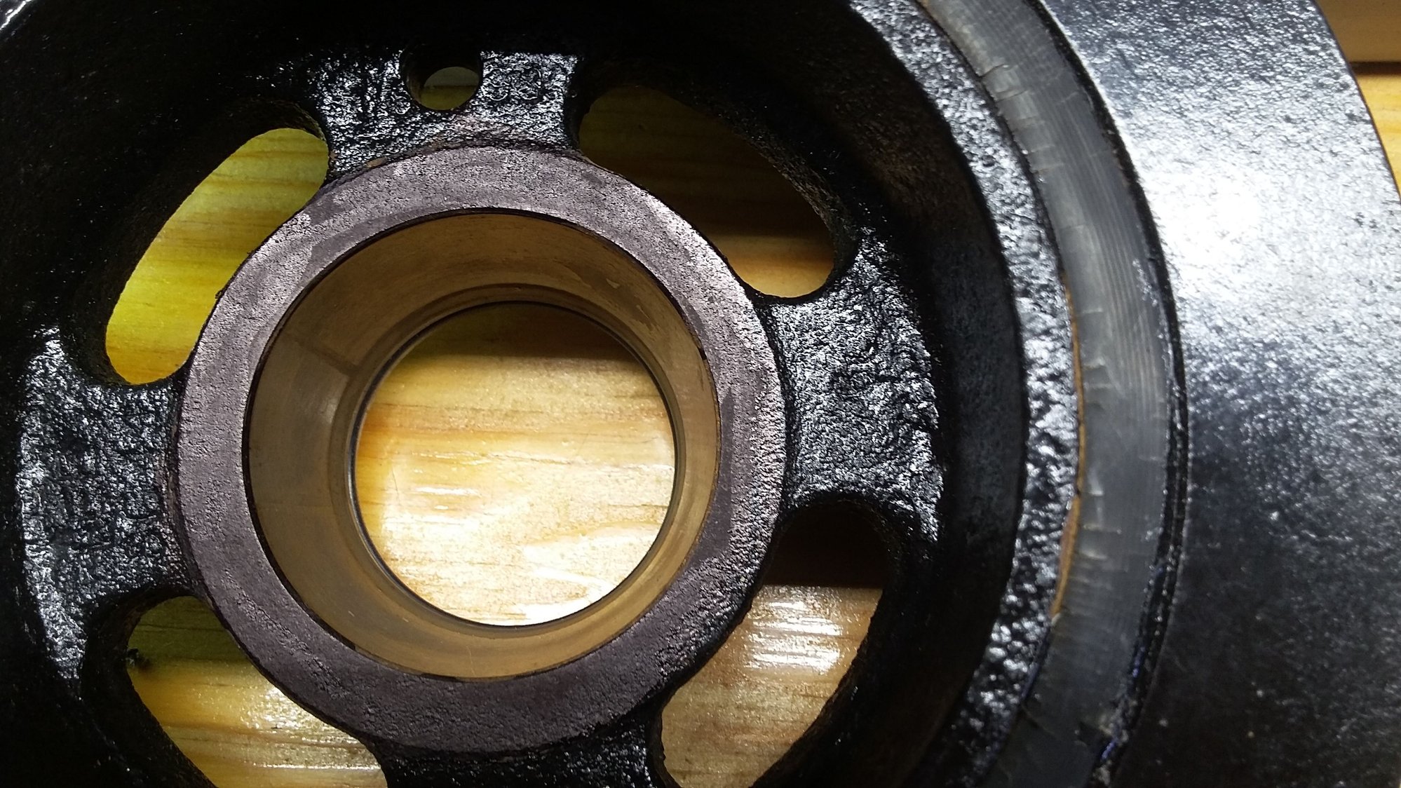

Do you have either dots or a line mark on the face of the balancer?
Old Apr 11, 2020 | 11:33 AM
  #264
Mrjay622's Avatar
Joined: Jul 2019
Posts: 398
Likes: 13
From: Piffard Ny
If I need a pipe not a problem.
Old Apr 11, 2020 | 11:35 AM
  #265
Carnival Kid's Avatar
Joined: Jan 2018
Posts: 1,841
Likes: 1,018
From: Redding CA
Definitely no keyway there! So you passed the Saturday Morning Observation Test! LOL
It is a little unusual that the harmonic balancer is not specifically aligned, but hey this is Jaguar, so we shouldn't be surprised.

Wow.. I passed something...
thanks guys.
Ill look again for any alignment marks.
Maybe that's why others said use a bolt or pry bar to hold the flywheel?

This is direct from Blackonyx's detailed removal/install and it does not specify like all the other instructions.
MM. Refit crankshaft pulley:
1) As when removing the pulley you need to keep the crankshaft from rotating. I used pry bar between the drive plate and torque converter with the handles supported with a jack to keep it from moving.
2) Place some form of shield behind the radiator to protect it
5) Remove front crankshaft seal protector
6) Put a good amount of grease on crankshaft seal
7) Install a new o-ring on the pulley. Apply some grease to the o-ring.
8) Install the crankshaft pulley
9) Install the split lock ring on to the crankshaft
10) Install the new crankshaft pulley bolt
11) Make sure that the crankshaft setting tool is removed from the torque converter.
12) Tighten the crankshaft pulley bolt (24mm 6 point socket (15/16" will also work)) to 364-386 Nm
13) Remove your method of securing crank.
14) Reinstall the two covers on the torque converter housing.

I read that too... I'm not seeing much of anything there expect the metal the the tool was locked into... hell I try it.
I also don't see the flywheel teeth as others have mentioned for the pry bar.

No markings..
everything is out of order. ..

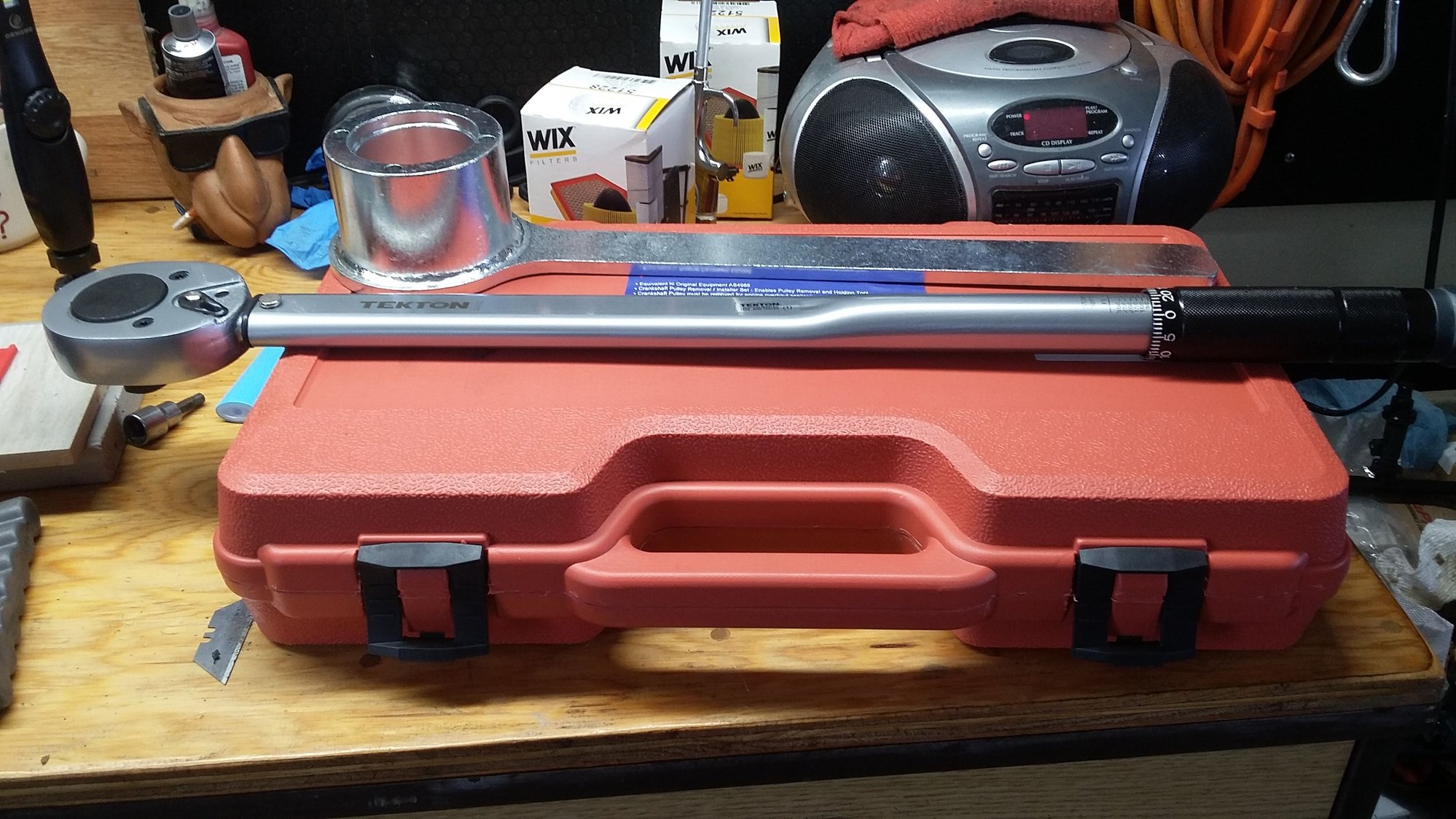

I would not recommend using the flywheel teeth to hold the crankshaft, once the harmonic balancer has "grabbed" the tapered collet you will be able to use the large crankshaft holding tool to tighten the crank bolt.

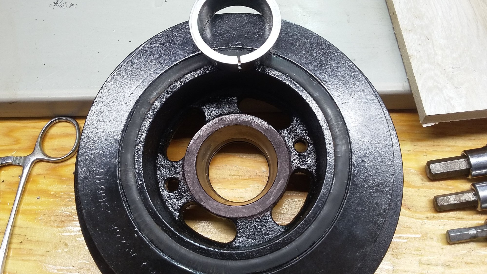

Ok i did what HH suggested it's all gooped up with BJ Weird waiting for it the cure.
Thanks. HH

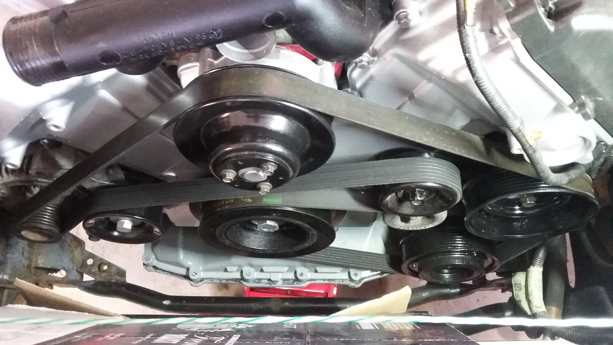

Hi guys .. Happy Easter.
ok that headache is over....

Lookin' good...
