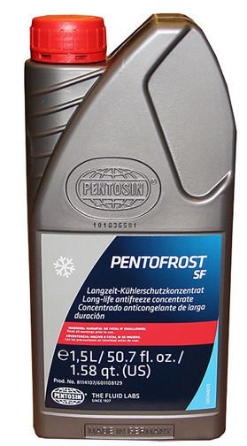

Originally Posted by Mrjay622
Like to know which antifreeze do you guys use?.
The recommended anti-freeze for the X308 is Pentofrost-SF, mixed 50-50 with distilled water.

Likes: 13
From: Piffard Ny
Hi CK...
That's not available anywhere near me.
Is there a substitute I can use.
I've already ran 4 gallons of water Thu the system it's finally starting to come out clear I have a few more gallons of distilled water to go..
thanks

Ok guys ... I read enough getting the exact recommended antifreeze is not going to happen this weekend or next week.
Right or wrong Im going to use what I have on hand for now... I have 3.5 gallons of Zerex G-05 It's what I use in the volvo, for now I don't think it will harm much since it had rusty green water in it... I'll completely flush it 1st...
thanks guys

Just use Dexcool or any All-Makes/All Models Universal coolant, they’re all “dexclones”. Dexcool and the specced Texaco XLC are basically the same stuff, same goes for VW G12.

Sorry, missed the fun, spent the day mowing!
MrJ, NAPA auto parts has the Pentofrost-SF antifreeze. It is a little pricey, but you do dilute 50-50 so it's half the price it first appears.
