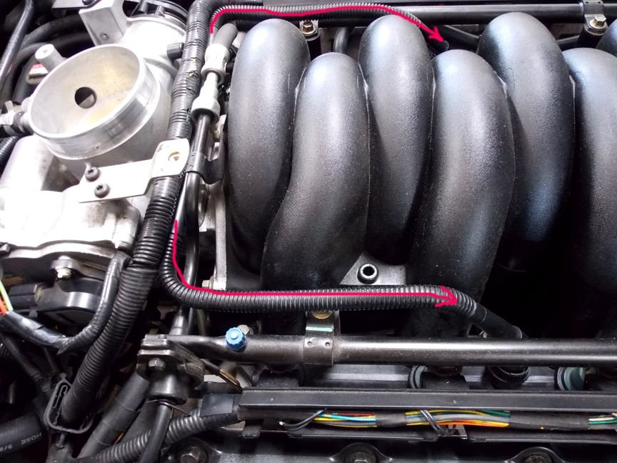

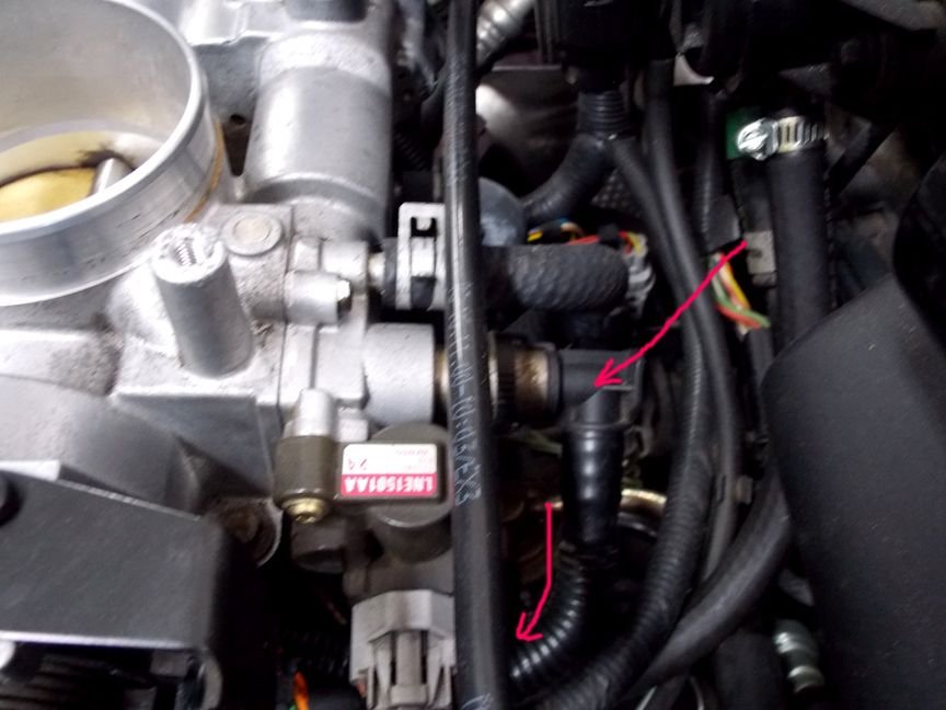

That hose #9, while shown in the diagram going "over" it actually winds its way "under" the throttle body, before emerging between the throttle body and the back of the intake plenum and pairs off to plug into either side of the plenum.
Connects to throttle body here.............
Emerges here and pairs off to either side of the intake plenum........

I have that figured out ,the problem was where it went under the throttle body it split found that last night gooped it with some ultra black gasket maker, good up 500 degrees F. also a small vac line that i also found. Its run[ning now sounds so much better and idle is steady at 800 RPM. I still have a little funky knock sound on the passenger side which is also the side I have 2 of the old injectors.
