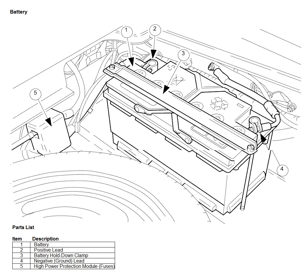

Old Nov 28, 2016 | 09:11 AM
Likes: 17,004
If you're convinced the battery is good and fully charged, check the connections in the High Power Protection Module (item 5):
If the connections are loose or the cables starting to break up at the lugs, it causes this issue.
If these are OK, next check the main cable connection at the Starter Motor.
