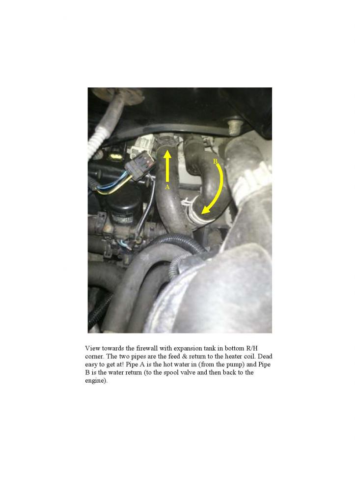

Where would the valve be? My heater blew cold this morning and was working fine last year.
Old Nov 17, 2015 | 02:06 PM
jimforrest (uk)'s Avatar
Joined: Feb 2015
Posts: 292
Likes: 125
From: Hampshire
The pic shows the water flow through into the matrix. You'll need the special pliers to release the clips and backflush through the R/H pipe (backflow).
The valve is the black topped pot to the left. The heater pump is almost immediately below it on the chassis rail.

Old Nov 19, 2015 | 01:14 PM
Blue_XJ8's Avatar
Joined: May 2012
Posts: 321
Likes: 33
From: Austin, TX
A yearly routine on my '01 : flush / backflush the heater core. Get heat back each time. I thought it was pump and/or valve at first. 4th winter in a row now where the flush does the job.
Just to clarify, and sorry if this is a stupid question, but when you say, "The heater pump is almost immediately below it on the chassis rail," you mean a separate, motorized pump that pushes hot water thru the heater coil box when the heater is on? Does this pump work only when car is on (or off)? I know some German car have an electric heater coil pump so that the heater will continue to work when the engine is warm, turned off, and only the ignition is turned to the on position.
I have has a low heat producing heater since I bought this car 3 years ago. I can get it "hot-ish" by turning temp all the way to high and then adjusting fan, but otherwise it/I never warm up.
Old Dec 14, 2016 | 02:22 PM
CharlzO's Avatar
Joined: Feb 2015
Posts: 998
Likes: 262
From: Upstate NY
The pump does allow water to pass through in "off" mode, if memory serves. However, when it's actually working, it pushes it a lot more effectively (just youtube the people testing them, you can see the giant jump in flow once power is applied). I had this same issue, and the pump was an instant fix once I replaced it. I believe the pump runs with power regardless of the car actually running, but obviously the temp will depend on the temperature of the coolant running through it, since it's only a pump, not a second heater. But if I turn my car off, but leave the heat on, I still get the heat so I'm pretty sure it's still pumping full without the car running.
