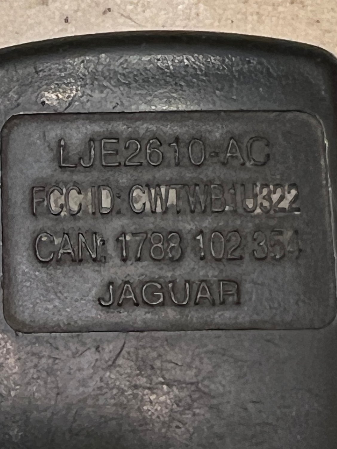

You’re correct. Can buy fob on Amazon for a few bucks. If had one, easy to buy another just by matching numbers on back. I have a 2002. Don’t know if all 2002s the same and likewise with 1998.

The key transponder and keyfob transmitter are two completely unrelated features.
You don't NEED the transmitter. It is a convenience.
You do need the transponder and TIBBE key cut to run the car.
The keyfob transmitters are different from the 1998 to 2000MY cars to the 2001 onward X308.
The 'rolling-code' transmitters are the difference.
