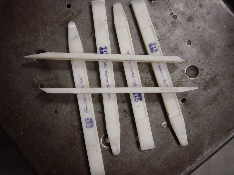

Update - I found this post about using thin plastic levers in another forum thread- there is a comment exacted from it:
Here is motorcarman reply in the general tech section thread:
Go to a windscreen/windshield shop and get some plastic pry sticks. They are like THICK popsicle sticks and have rounded tapered and wedge ends (opposite). I use these ALL THE TIME.
I also need to remove the front door panel - problem with the windows not going down all the way. I brought some wooden craft sticks at our local Walmart store (150 pieces pack for $2.99). I will be trying to use them on the veneer door piece (I am not sure if they are thin enough).
