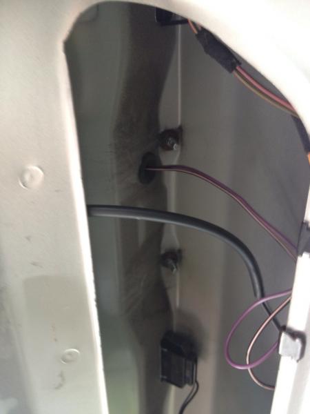

Looked at all the wires and they seem to be looking fine, and so does the #10 10amp fuse in the trunk... Im figuring it could be the button mentioned earlier,
still investigating, i could not get a good pick of the wires on the latch, but they all seem fine,
