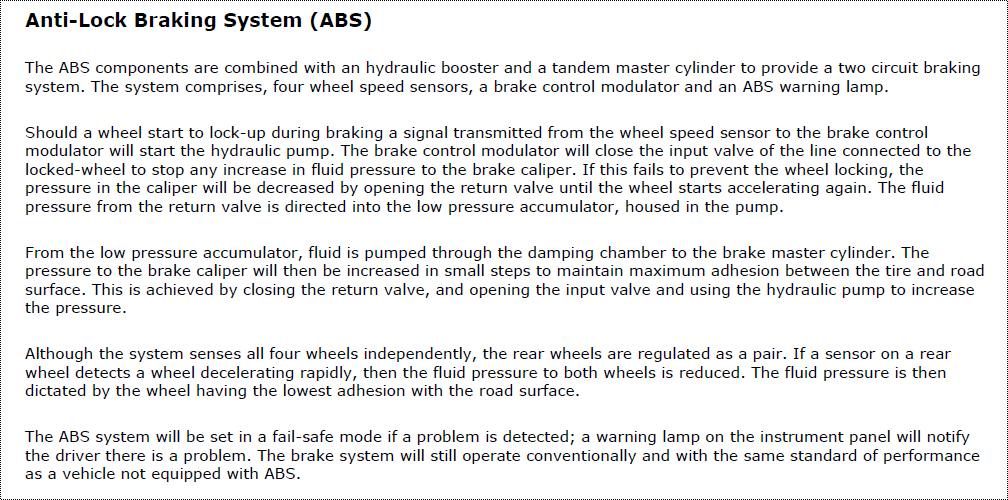

Folks, are the ABS and wheel speed sensors one and the same thing...i.e. four sensors, one on each wheel?
That's part of it. Here's the description from the workshop manual.
Attached Thumbnails 1999 XJR question: ABS Traction control-abs.png
