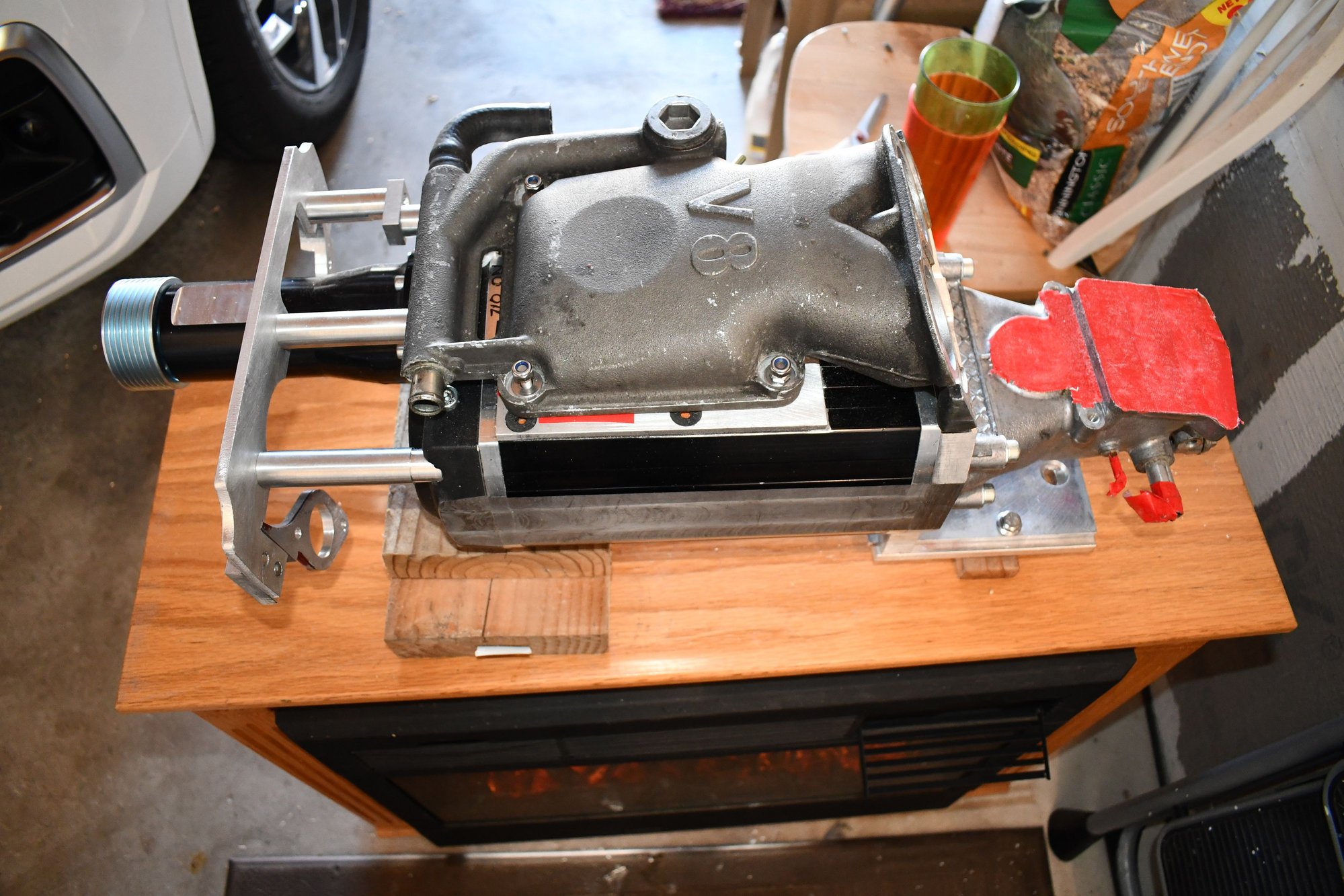

Lots of fun was had yesterday successfully test fitting a 2.1 KB to an X308 XJR.
The plenum and rear elbow are much less restrictive compared to on the later AJ33S in the X350 and STR, and we are expecting around 450rwhp, as others have achieved with this supercharger on the 4.0 supercharged cars.
This kit will also fit the AJ27S in the X100 XKR for anyone seeking a lot of extra power.

Finished product, although the top plate needs a polish or paint. This will be bolt on for XKRs and XJRs.

Do you know if the front bracket that you had made will interfere with the hood insulation when closed?

It was test fitted and sits far below the chargecoolers and other original equipment in the engine bay.

That's awesome, nice work. Anything else required to install?

Set of cooler plugs and you're good to go.

Very interested in this kit, well done on all your work
Can you hear excessive extra whine with this fitted?

from the video above it sounds almost the same, they're a compressor and more efficient than the M112 blower fitted as standard.

Thank you Peter, it was quite a lot of work as we wanted the quality to be as high as possible.
On normal driving I would say it's not, but it is louder at WOT yes (higher pitched too). You can easily increase or decrease this though with a 5 minute pulley change.
What do you mean?

The spark plugs need to be 1 step cooler.

Here's the short story of the long journey the kit took from Wales, UK, to Gardnerville, NV, USA:
UPS picked up the package from OP's on October 24. Tracking was normal for the first few days, then stopped. OP contacted UPS and an investigation was opened on November 1 for a "Lost Package." The investigation went on and on, and by the middle of December, OP began negotiating with UPS for a settlement. In the meantime, OP and I came up with a plan to replace the kit. On January 3, OP received an email with a picture and was asked if this was the shipment. They had found it somewhere and apparently the shipping label had been torn off. UPS put on a new shipping label and got it here on January 9.
So, it's in my garage, but the install date is yet to be determined. It's cold here in the winter and my garage faces northeast, so it doesn't get any sun. I will update this thread when I get started on the install.

And, I put a hold on my parts gathering when the package went missing, so I'm getting back in to that. It's time to replace the hoses under the SC and I want to do the heater hoses (the octopus) since they're now 23 years old. Plus the 3.5-inch intake tube, fit the oil catch can, replace the cam cover gaskets and the spark plugs, and change out the lower pulley from the 7-inch to a 6.3-inch.
