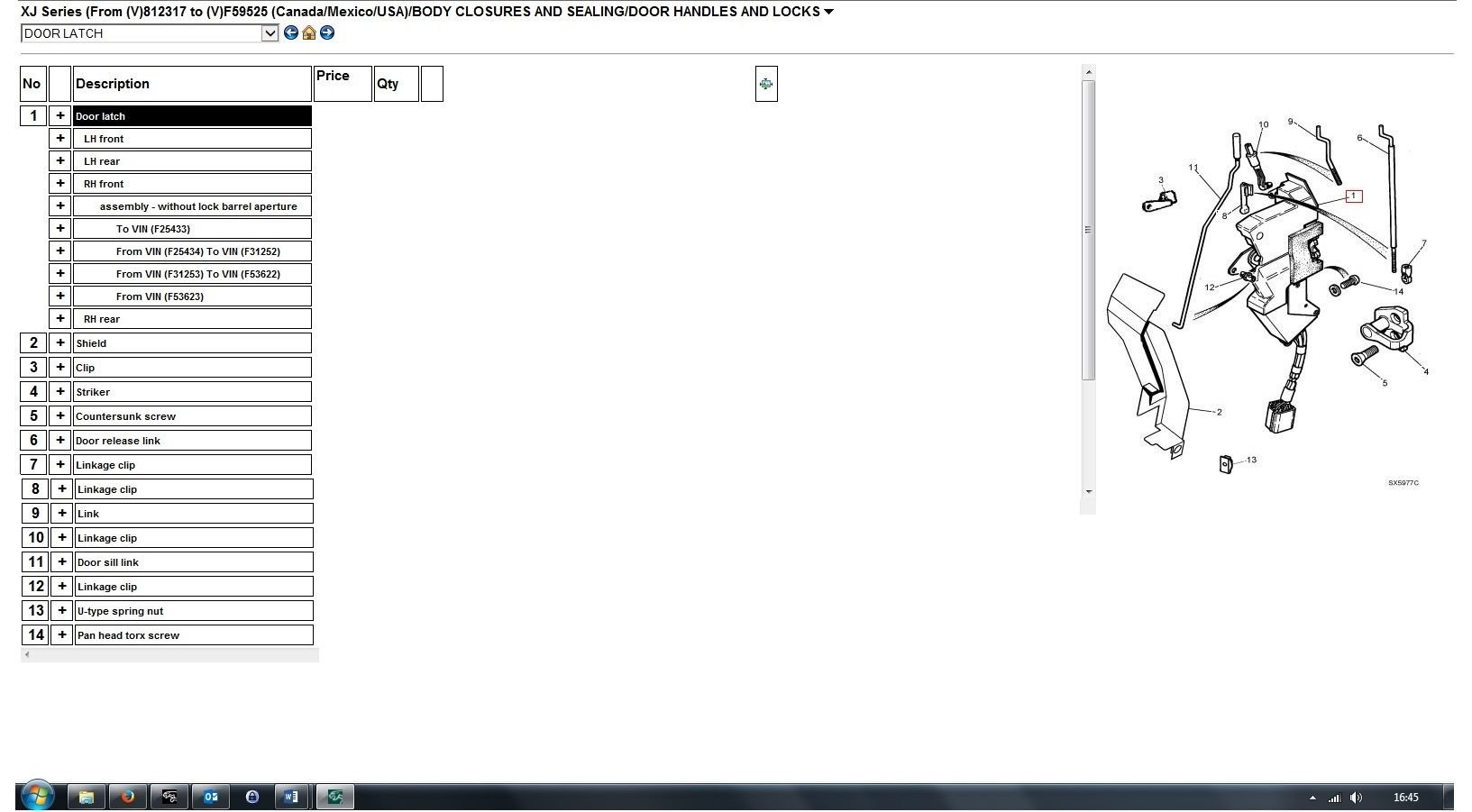

Review this video (this guy is pretty descent) and since you have your door card off already, skip to the 7 minute mark...
...and again at the 9 minute mark he has the assembly in his hand. I suggest watching the whole thing, but make note of those points.
Let us know...
Back again, this isn't the best detail parts assembly drawing, but it may help?

I watched Roberts video to get the panel off, but stopped when he could open the door by lifting the actuator and pulling the wire. Thanks for letting me know that he holds one. Every eBay pic of one is either really dark or just shows one side, hopefully between Robert and your diagram, I can figure out what I’m missing. If not, I’ll take the other panel off the passenger side.
