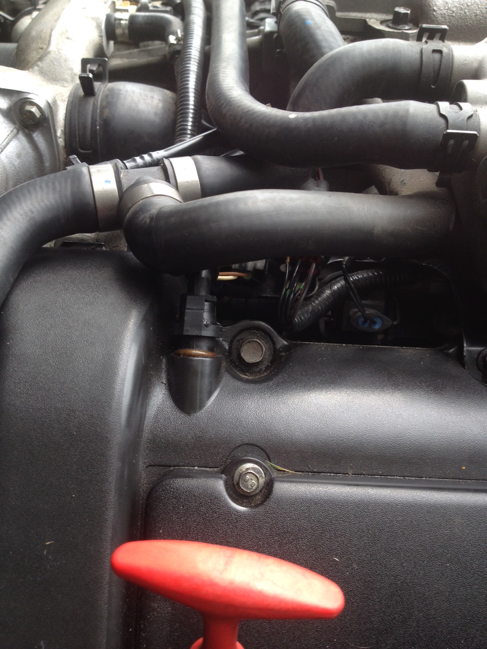

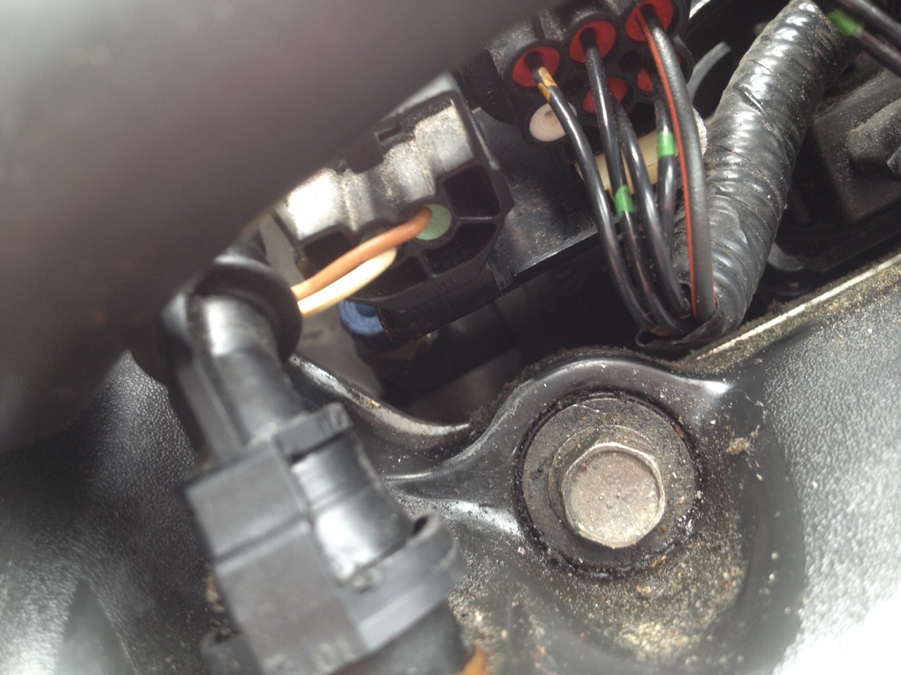

Well it's difficult to get a clear picture because the part-load breather hose, supercharger coolant lines and some electrical connections are occluding the view.
The first picture is the "location", basically just behind the part-load breather connection to the valve/cam cover. The second picture is looking underneath and just past the part-load breather connection and you can just make out part of the blue dust cap that's threaded onto the schrader (sp?) valve connection.
I had to remove the part-load breather connection and then loosen the two nuts holding the metal bracket onto the valve/cam cover. After I loosened them, I lifted that little tray up and slid it away from the fuel connection. Moving that tray, and the electrical connectors on it, allowed enough room for me to snake the test hose down through the coolant lines and get a straight on angle.
I hope that helps.

That looks to be just where it is on my XK8, on which it's hard enough to connect, but the XJR should be many times more difficult.
