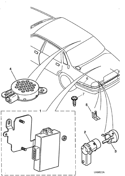

Question Where is rear parking sensor/assist sounder located in X308 cabin?
Where is the rear parking sensor/assist "beeper/sounder" installed inside the X308 cabin?
This is part 4 in the attached diagram.
Attached Thumbnails Where is rear parking sensor/assist sounder located in X308 cabin?-x308-park-aid.jpg

Figure 19.1 of the Electrical Guide states that the 'Parking Aid Sounder' is located 'Parcel Shelf'.

The sound comes from the passenger-side corner of the rear parcel shelf (I've sleuthed this previously), so presumably if Bob is correct it is under the parcel shelf on the passenger-side of the vehicle. To access that, open the trunk, pull back the fabric liner from the trunk-interior under the rear-window, it would be somewhere in the 2-3" gap above the fuel-tank below the parcel shelf.
Won't work. the speaker/sounder is on top of the metal parcel shelf, not underneath it.
To get to it you have to remove the rear seat, seat belts and parcel shelf trim

That's a lot of work to access a tiny piezo speaker, lol.
As for rhd/lhd variants, it would likely be on the US-style-passenger-side in all cars as the ones equipped with premium sound put the subwoofer on the other side of the parcel shelf.
