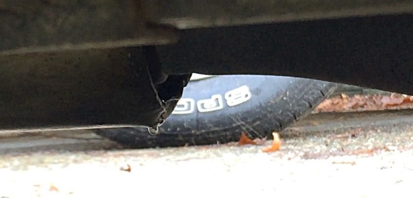

Also I was looking under the car and noticed that a liquid (I believe it to be water) was spewing from a section of the exhaust (roughly under the driver/passenger seats). Could a leak like this cause chaos with the sensors and cause the issues with driving the vehicle?
I took a video of the the spewing and attached a screenshot below.

any Muffler shop should have the gauges to check for a Bad cat and aftermarket replacement at reasonable cost , Call first and make an appointment to have them checked , saves lots of time , A car that has gone fuel Rich can overheat the Cats and cause a Meltdown

You need your OBDII codes read, including short term and long term fuel trims. I would bet you have dirty injectors, a dirty MAF sensor, and other fuel related issues. How new are the spark plugs? Rotten eggs smell points to overly rich running (spurting, not spraying injectors, bad plugs, dirty air filter, maybe bad O2 sensors on either or both bank).
Try something simple: clean the MAF sensor, clean the throttle plate and bore (gently), run a can of fuel system cleaner through a tank of gas.
Finally, you have changed out the secondary tensioners, right?
In frigid snow country, I would never rule out bad gas or water in the fuel tank. Problem is less frequent now days with electric fuel pumps, but icing is still a potential problem.
