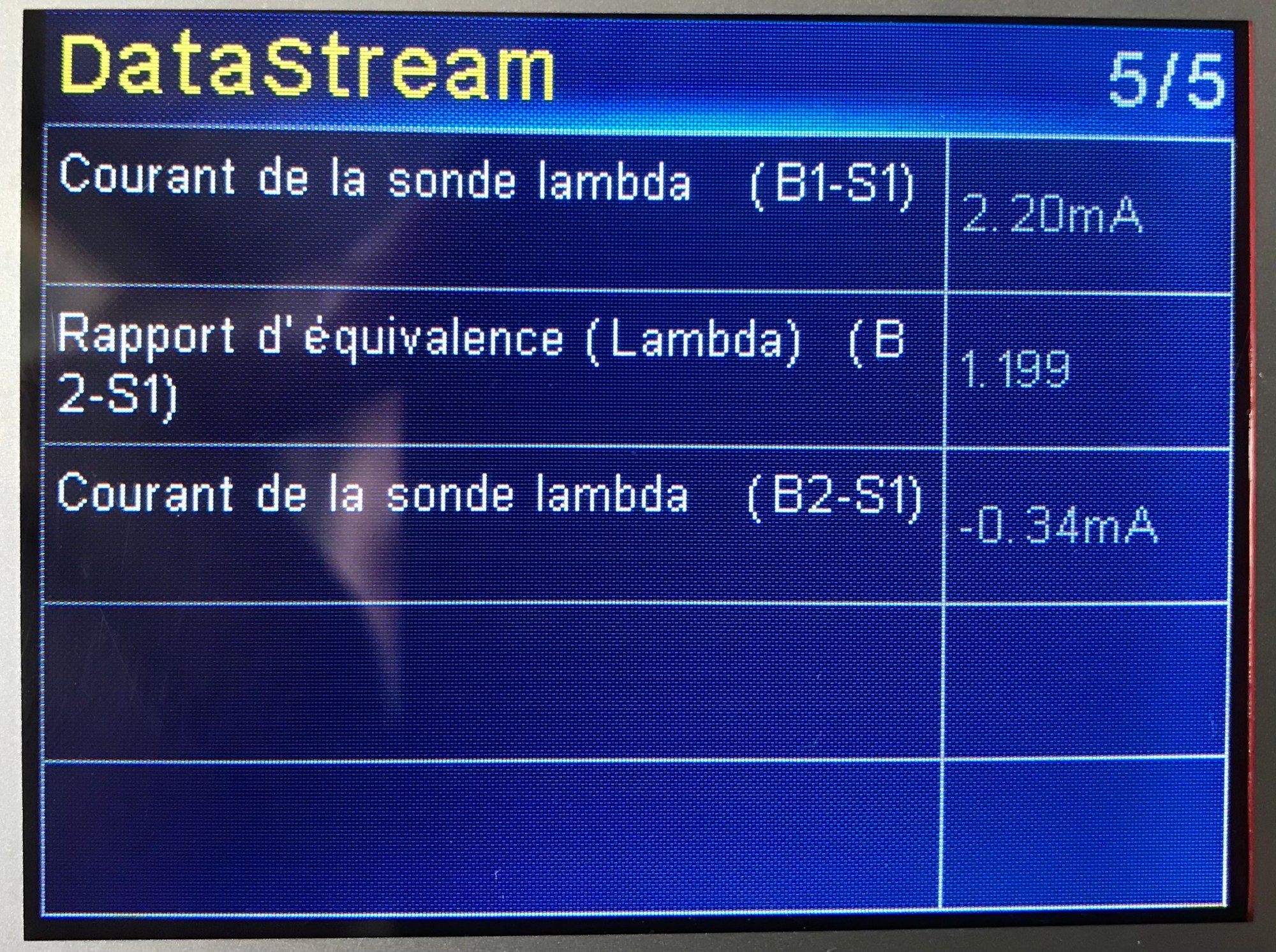

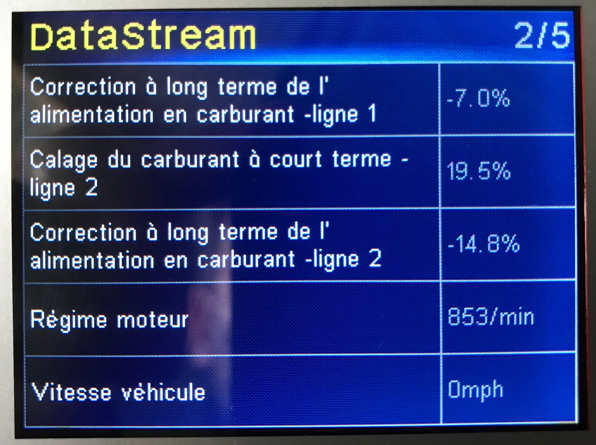

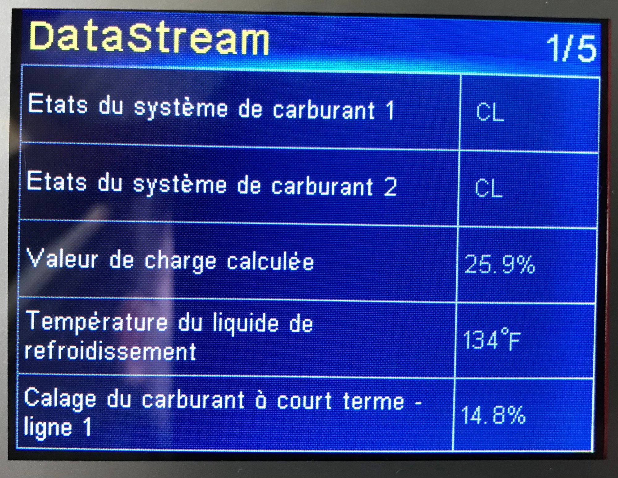

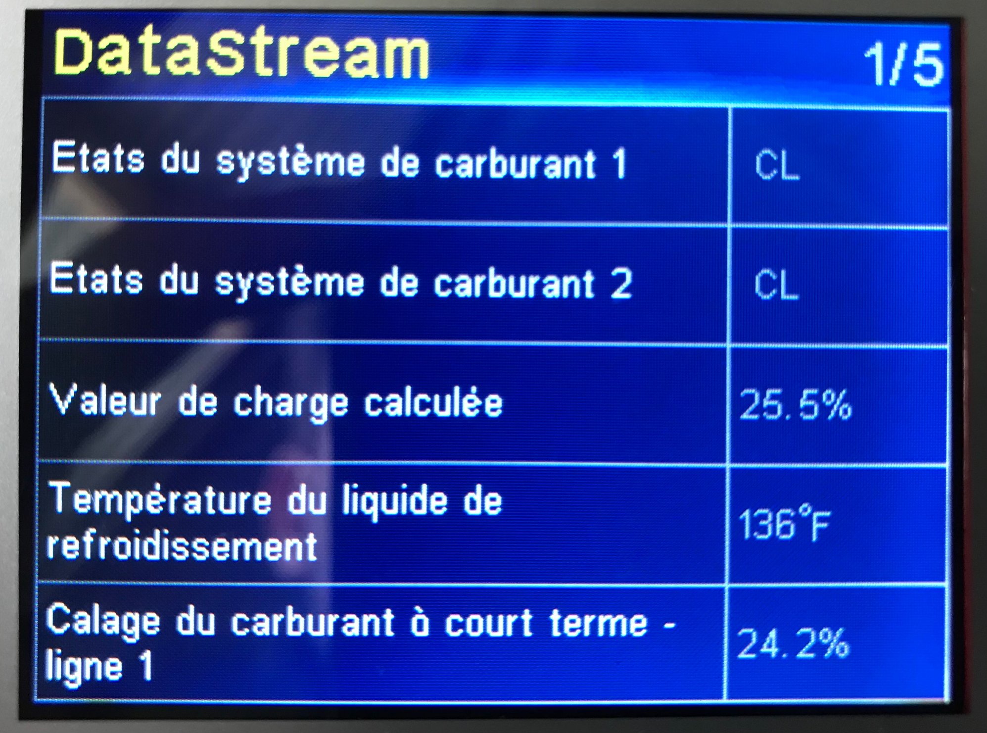

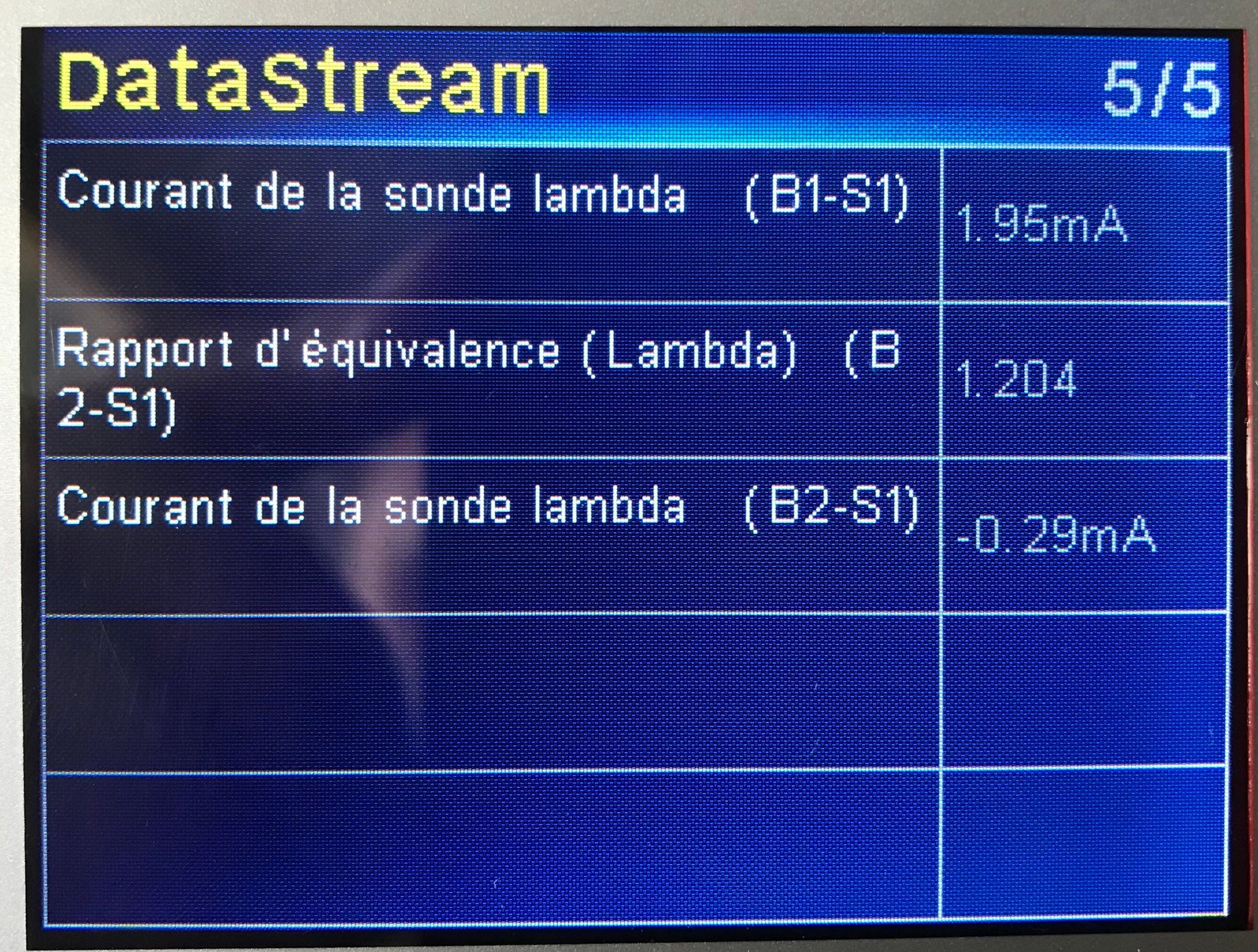

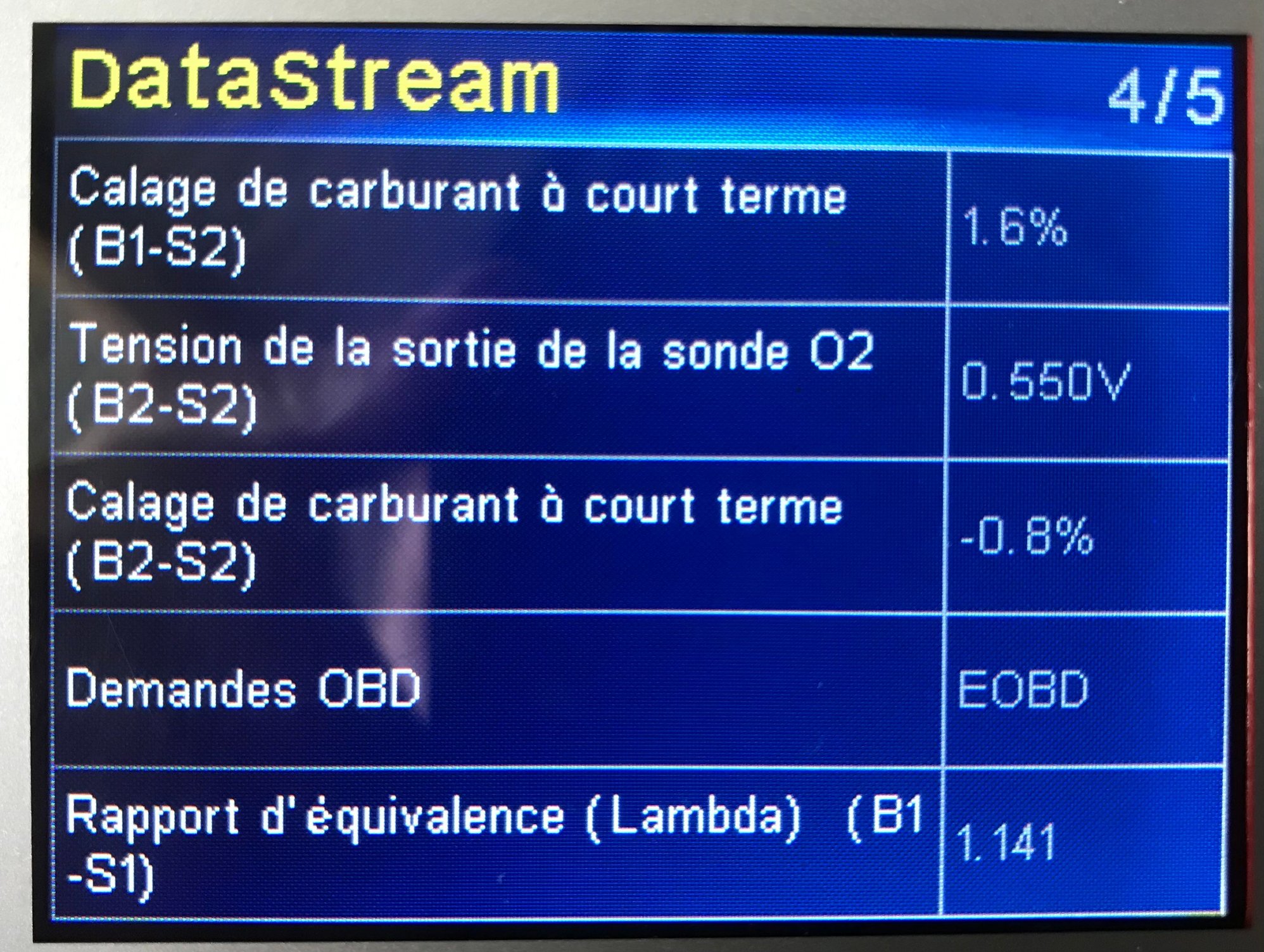

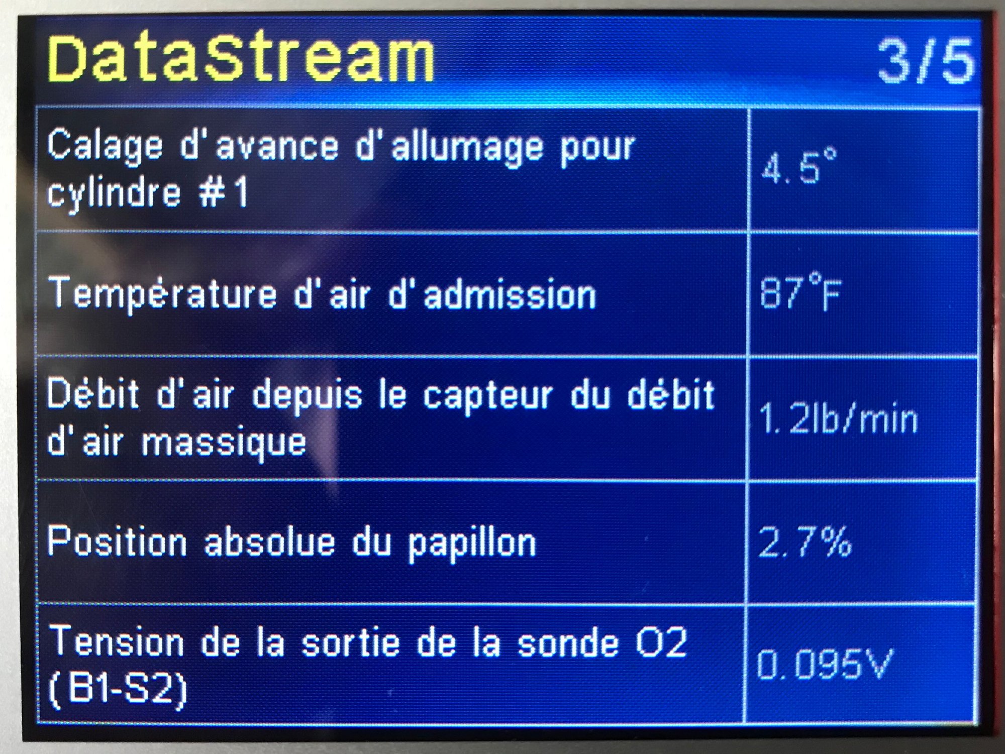

Thank you for answering! I’ll take pictures and share...

Old May 12, 2021 | 08:19 AM
jacksjags's Avatar
Joined: Oct 2019
Posts: 118
Likes: 13
From: Versailles

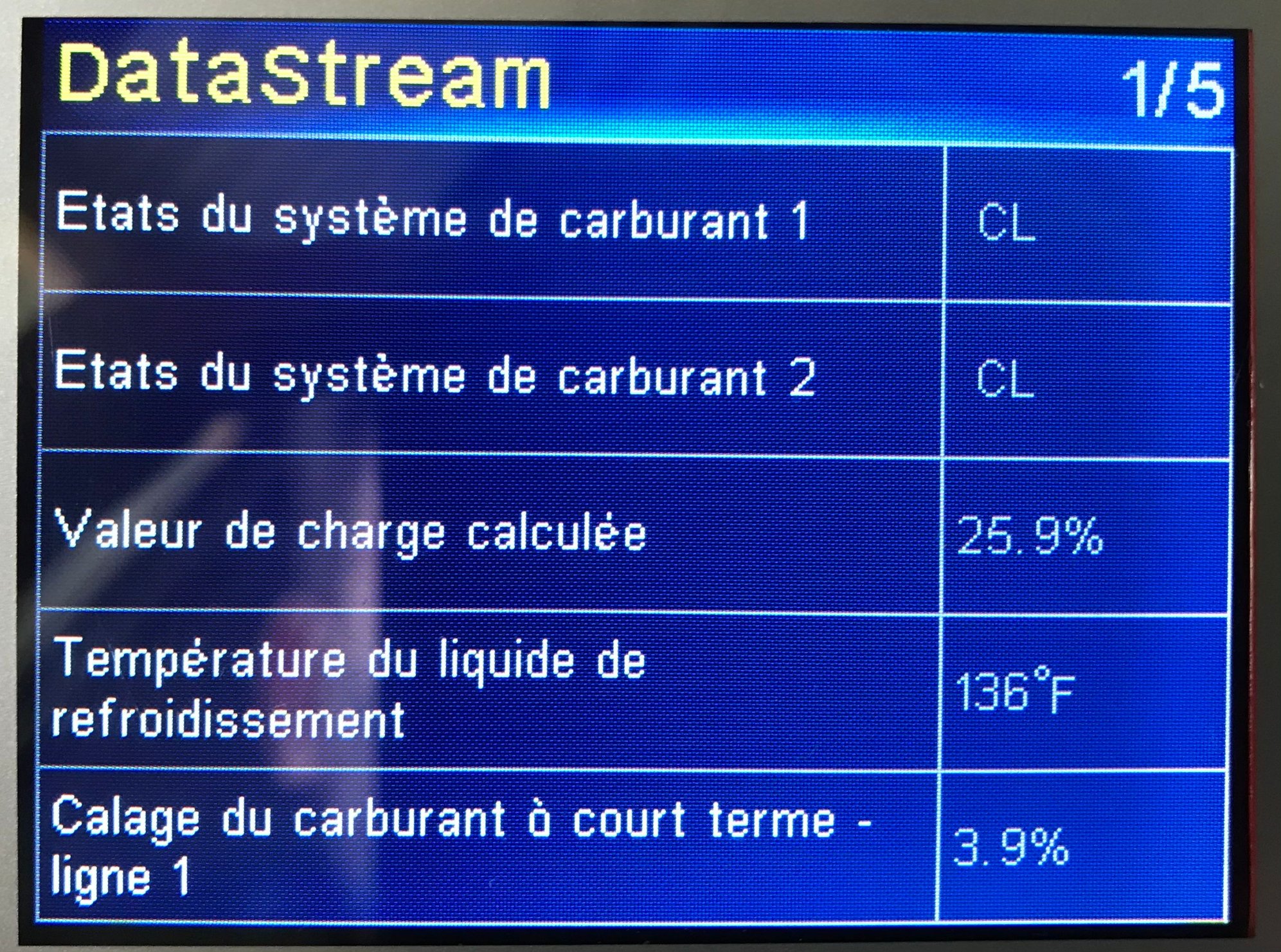

It's in french but I'm sure you can guess what value is what... STFT is "calage carburant a court terme" and LTFT is "Long terme"
Old May 12, 2021 | 08:21 AM
jacksjags's Avatar
Joined: Oct 2019
Posts: 118
Likes: 13
From: Versailles
"temperature liquide de refroidissement" is water temp. "température d'air" is air temp. FYI : the car was warm 3 hours ago. Here I just turned it on to take the values and temp gauge was half way cold...

See how bank 1 STFT jumps. That’s why I posted several pictures of page 1

Clean the throttle bore and plate. Replace the MAF sensor with the old one. Maybe need a new temperature sensor (in the cross pipe). Your water temperature readings are telling the ECU to enrich due to cold . . . MAF? Temp sensor? Thermostat? Coolant mixture?

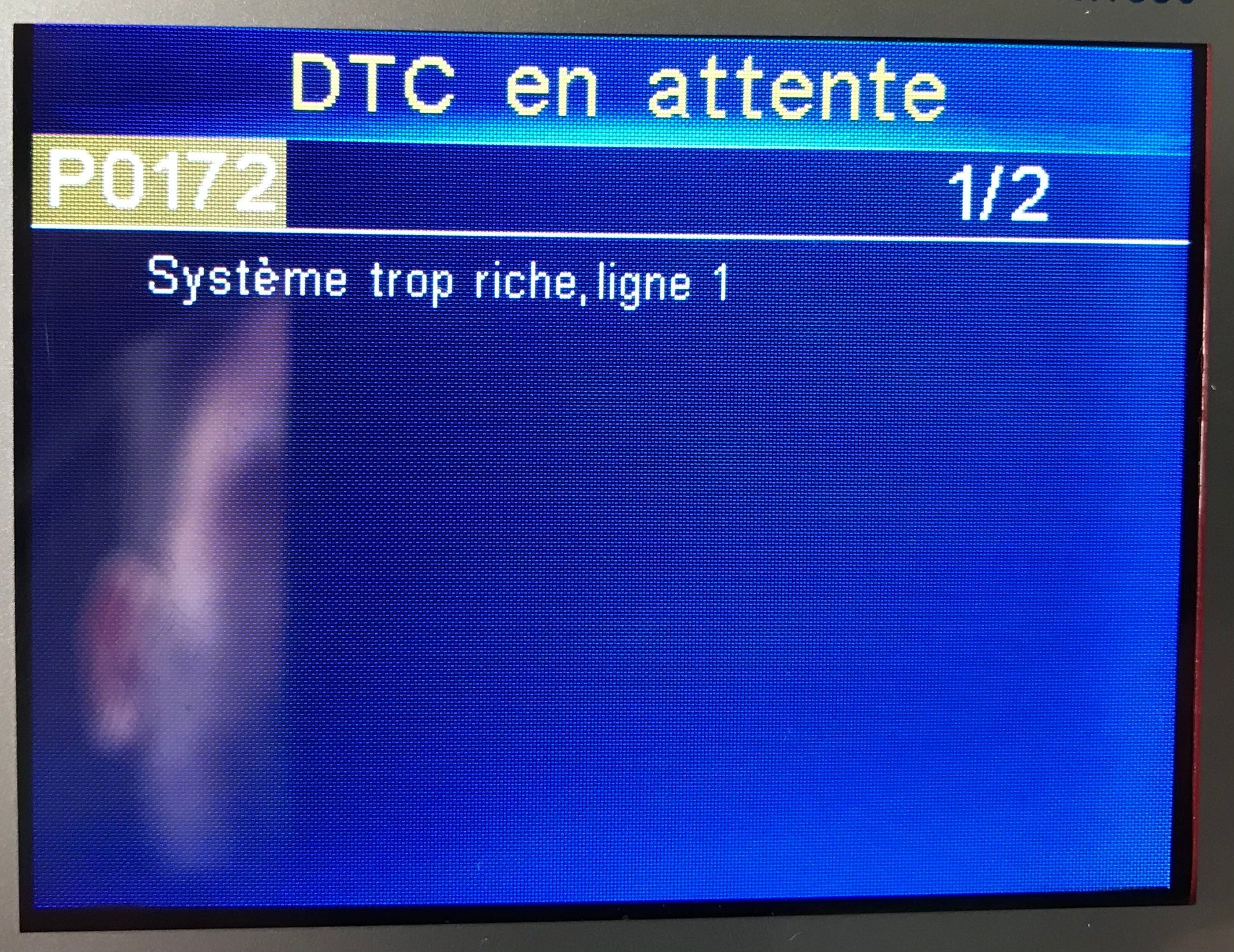

Let me get this correct before jumping to any conclusions:
1. Is the date fresh after a hard reset of the battery, or accumulated over a certain mileage?
2. Do you have any other codes than the P0172?

I agree with Eric (fortunately, he didn't answer in mandarin). I was concerned with the coolant temperature -- but yours likely at startup -- which Eric points out. Should run fifty - fifty water to coolant (coolant choice as suggested in Drivers' manual - most likely red stuff) and after stabilizing, should be very close to 212*F or 100*C, not 134*F.

- The very large difference between the LTFT (-7 & -15) and STFT (~ +20), but I have no idea if this is momentary or structural,
- The difference between bank 1 and bank 2 (indicating there must (also) be a non-shared component involved)

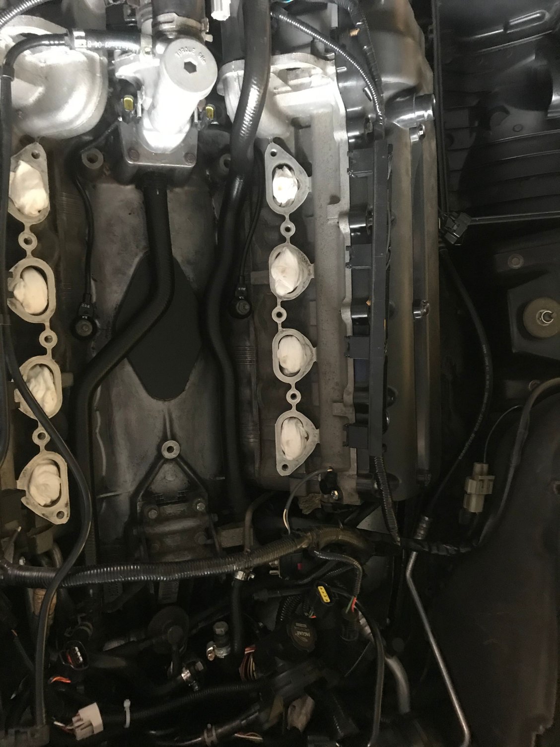

The last operation I did (last week end) was to remove the intake plenum and check all for a leak even if my smoke test showed nothing. Besides the usual oil in there everything was absolutely clean and all gaskets are perfectly fat and soft... about injectors: I have 3 sets. The original ones and two refurbished ones from different sellers. With all 3 I have the same results... I’ll add all breather hoses were changed when the engine was rebuilt last year. As well as all other hoses for that matter. The rebuilt was 15K€ so no expense spared as that car is a daily driver. Not a Sunday car: I have my series 1 for that purpose. I’m waiting for a new air filter before performing the test as it’s over 6 month old and I go daily on dusty construction sites... it might be dirty.

See how clean the valley is... overall condition is consistent: when the car was rebuilt 100% of the engine bay was empty.
