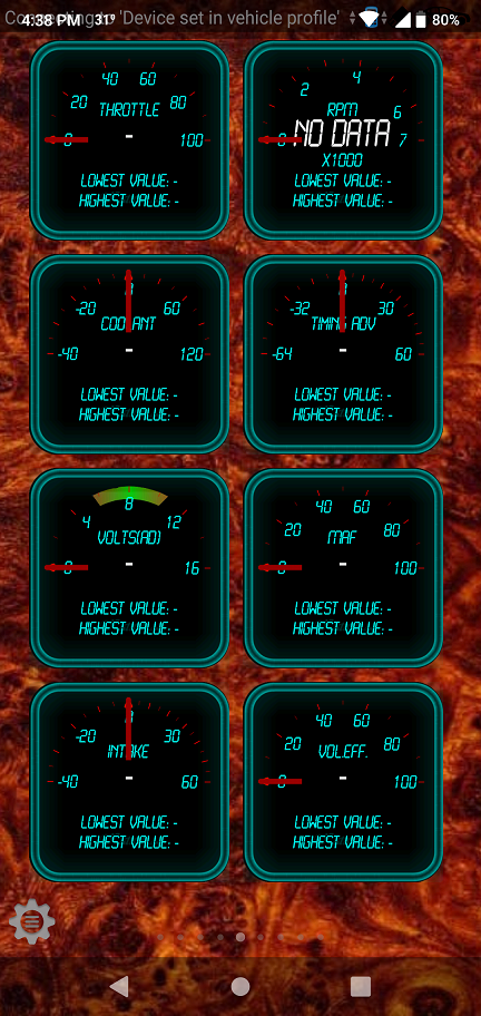

I can set you up with some basic values of the various sensors, maybe starting at idle.
As mentioned before, I use the Torque Pro app, which is surprisingly handy.
It allows to log a sensor, but I never used that.
Instead, I use gauges which do not only show the live data, but also record the highest and lowest value over a test.
That saves me from continuous looking at the gauge, still helps me with the diagnose afterwards.
You might want to buy a ELM327 if you run an Android phone, they cost hardly anything.
I enclose some screen shots (not connected to car) and the ELM327 dongle.
