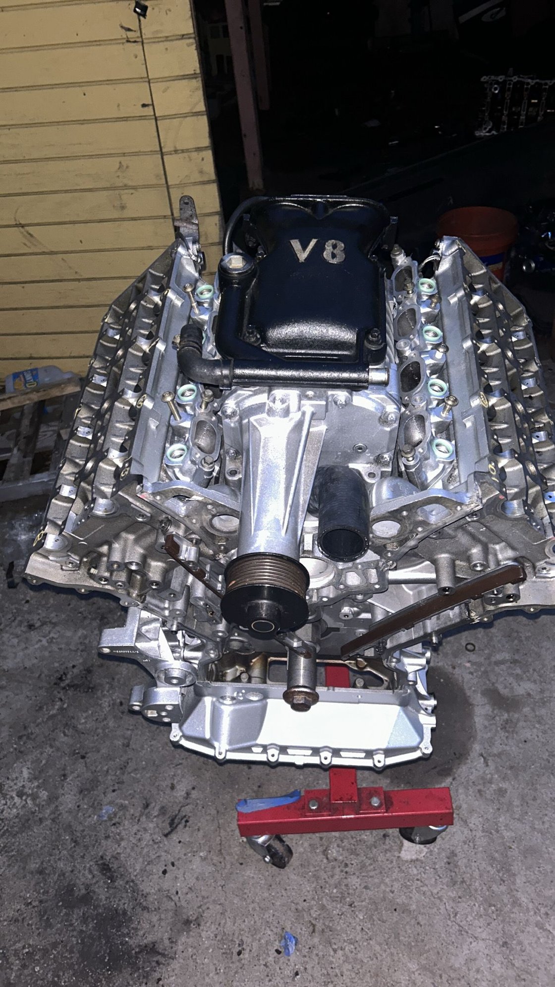

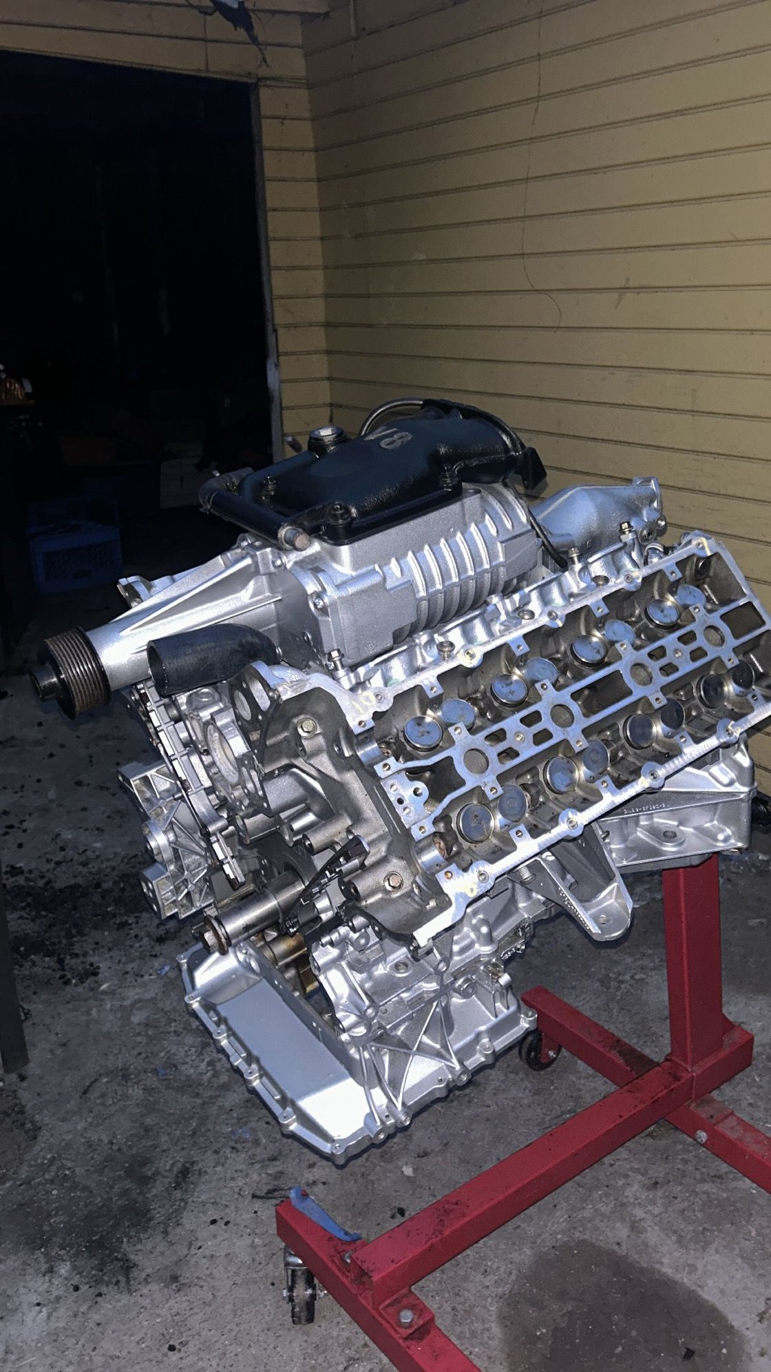

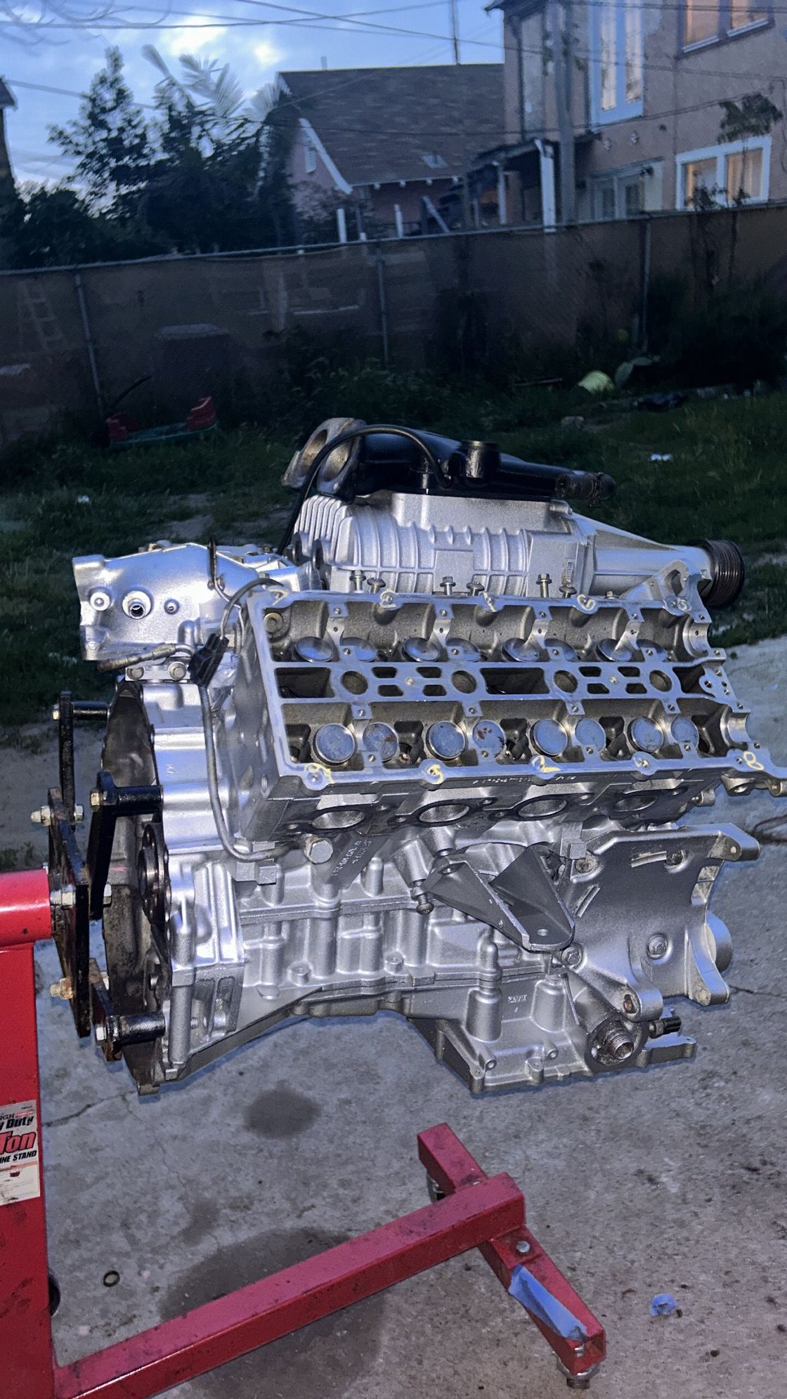

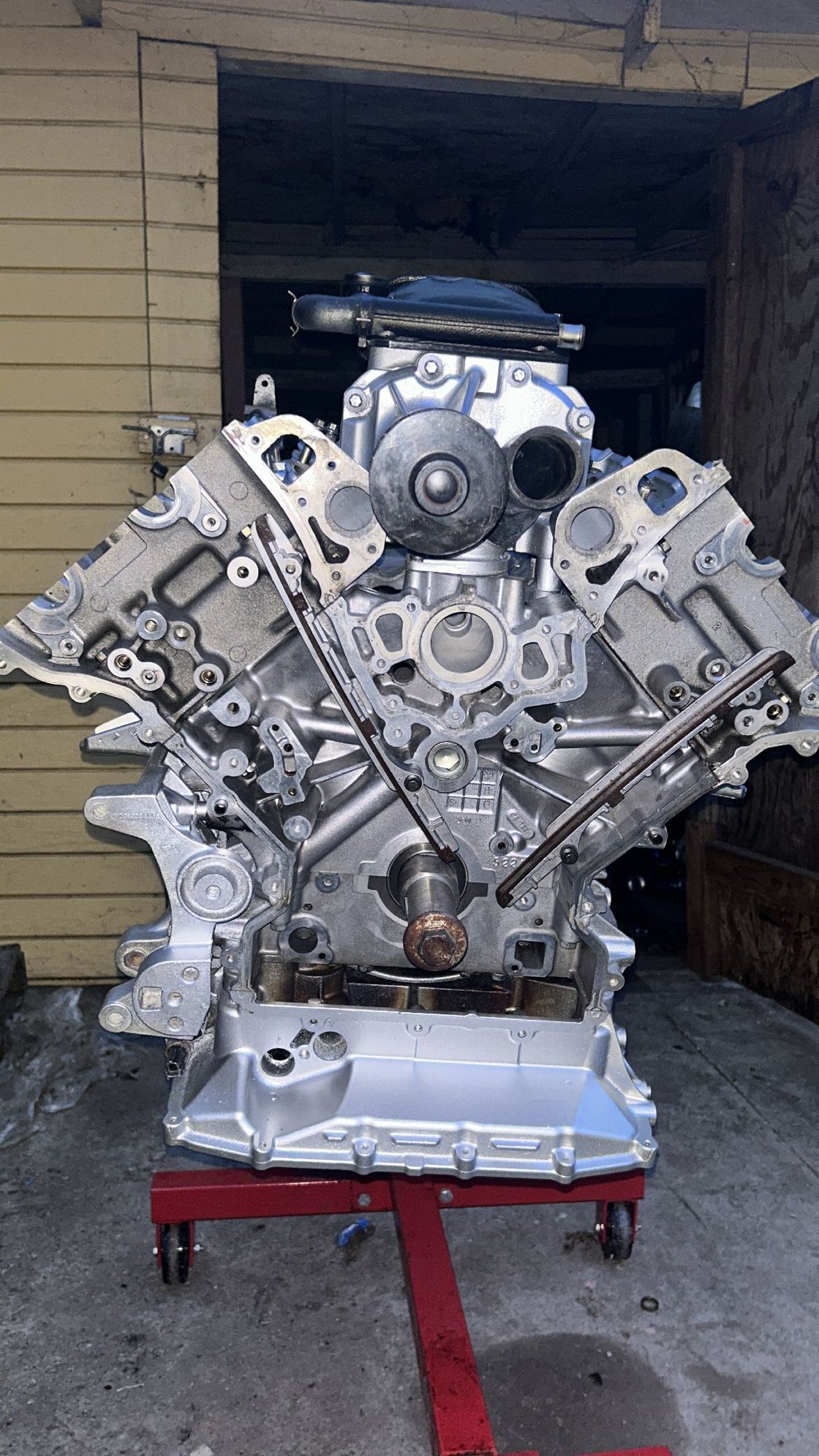

So far so good so what! Almost complete just to throw the cams back in and brand new timing components for the most. Replacing hoses along the way as needed. Oh and decided to put 02 XKR block with the XJR heads bolted right up. Pretty fun project so far. Anyone have suggestions on any supercharger pulleys,headers,down pipes,etc? Any suggestions greatly appreciated

It was my first car I bought when I had turned 18 a lot of sentimental value forsure. It was no fun buying new motor and putting it in anyone can do that. I’d rather take my time put piece by for personal satisfaction and entertainment.
Threw the camshafts in today set them to time just need the remaining timing components and seals.
