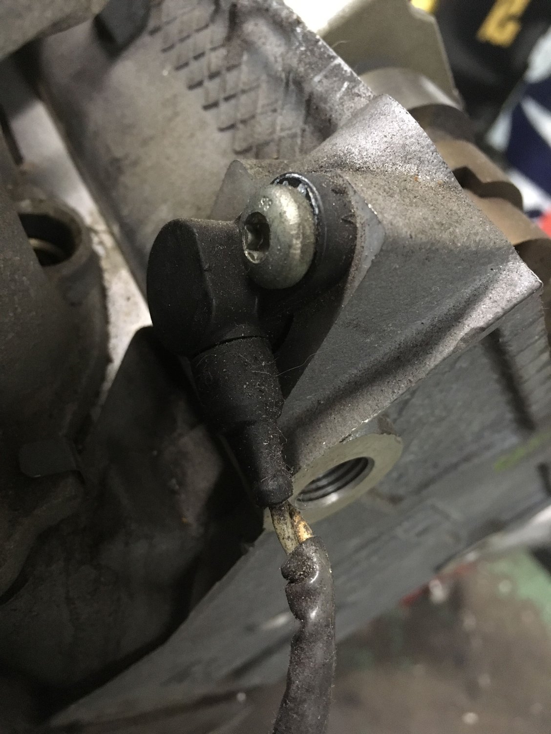

A 99’ should still be a AJ26 engine. You have a AJ27 car with an AJ26 engine now. The sure way to tell is if the right bank (or bank 1) camshaft sensor on the rear topside of the cylinder head is present or not.
Photo above. AJ26 engine without camshaft sensor on right bank (or bank 1)
AJ27 engine with camshaft position sensor.
If you dont don’t have a cam sensor on bank 1, you’ll have to swap that head and camshaft onto the good engine.

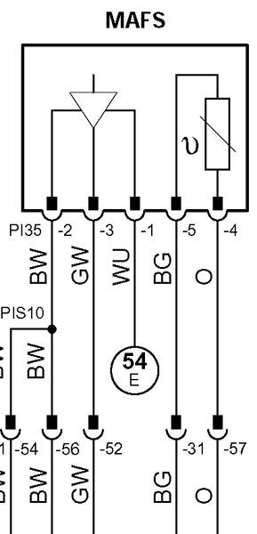

yeah sensor is there, did more test on maf not getting 12v or ground on any of the pins need a wiring diagram.
of the 1999 xjr (heads are different) .... I did use the cam positioning tool can't find any cam sensor on either the 2002 or 1999 bank 1 heads
I think only the xj8 has these.
The MAF gets 12V supply via its pin marked "54 E". However, when this supply comes in is controlled by the ECU so you may not see any 12V on the pin when just switching the ignition "on". All other MAF pins are connected to various pins of the ECU so, again, you will not be able to establish which one goes to the ground as the connection to the ground (if any) is controlled by the ECU. The ECU probably switches the 12V to the MAF only once you start cranking the engine.
