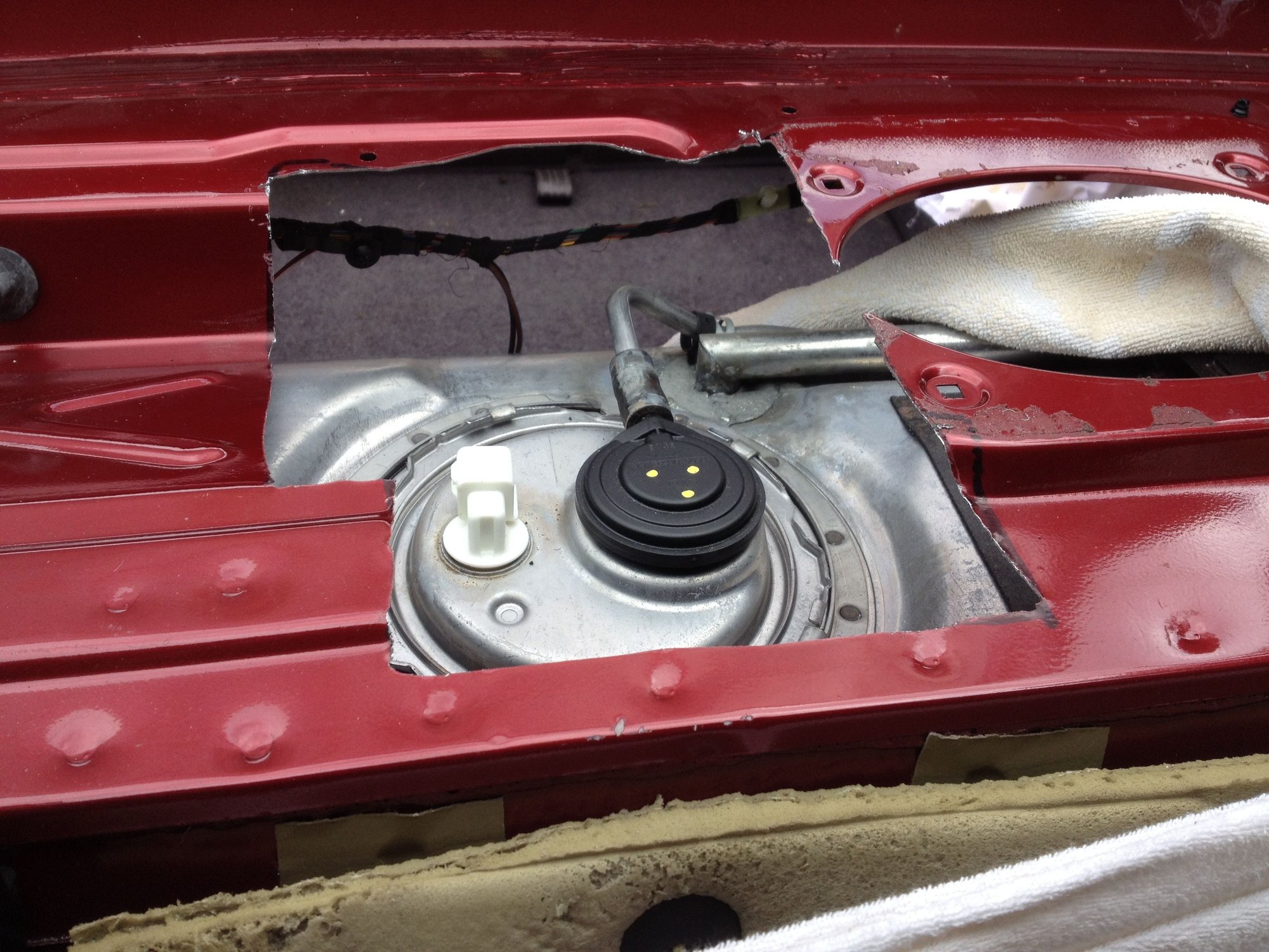

There are 3 methods of replacing the pumps.
1 Remove all the fuel/vapor lines and pull the tank into the boot area for EVAP flange access to the tank interior.
2 Cut a hole in the parcel tray area to access the EVAP flange and pumps.
3 Remove the tank straps and force the tank back far enough to access the EVAP flange but leave the fuel lines attached under the car.
I charge about 4 to 5 hours to replace the pumps and fuel filter.(I cannot count how many I have done in the 3+ decades since Jaguar put the pumps in the tank, dozens and dozens? XJ40 onward)
I have NEVER cut a hole in a customer car for the pump replacement.
I have NEVER dragged a tank back without removing the fuel lines from underneath.
If you decide that you are clever enough to 'beat-the-odds' of NOT damaging the fuel lines by dragging the tank back 'just enough' to get to the EVAP flange, then PLEASE do not cry to us that you damaged the NO LONGER AVAILABLE fuel lines and now you wish you had done things differently.(too many sob stories for me to care)
Good luck and let us know how it comes out.

This is the solution
A good mechanic that knows what he's doing would easily do that , pulling the tank is bad idea I had to access the wiring around the pump 3 times some wires needed replacement I can't imagine pulling the tank 3 times cutting inside the car to access the tank much better just remove the 2 seat and the rear cover done all the lines and tank obvious
Old Jan 11, 2025 | 02:34 PM
Hell-Cat's Avatar
Joined: Mar 2021
Posts: 174
Likes: 139
From: Western Mass
Arrggggghhhhhh........my eyes !!!
Old Jan 11, 2025 | 02:40 PM
motorcarman's Avatar
Posts: 13,699
Likes: 9,645
From: Wise County,TX
The problem is that when a shop takes it upon itself to 'cut and damage' a customer car without permission, the shop opens itself up to a VERY EXPENSIVE LAWSUIT!!!!!!!!!!!
If the customer agrees to the invasive procedure, then you will likely be OK.
I personally have never been sued by a customer so I am careful about what I do to a car.
Old Jan 11, 2025 | 02:47 PM
Hooli's Avatar
Joined: Sep 2019
Posts: 1,211
Likes: 684
From: Doncaster, UK
Indeed, if a garage did that to my car. Then they'd be replacing the car with an undamaged one.
