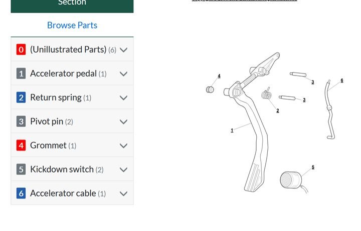

I have no direct experience with this, but the SNG Barratt fische shows a sturdy accelerator pedal system that pivots on pins, and operates a cable.
The cable attaches to the throttle body under the hood.
Check the cable at the throttle body, maybe it is broken?
With a flashlight inspect the accelerator pedal to look for damage.
I can't think that repairs will be serious.

Yup, on #1 where it clips onto #4 is the problem. Appears that the attachment point on #1 is indeed a plastic ball socket which #4 (a steel ball for pivoting) presses into. Looks like the guy cracked off the ball socket so now the entire pedal just flops around as it is no longer attached to that pivot point.

Difficult to visualize what has happened to your mechanism as my gas pedal looks to pivot on a simple steel pin, and I can't imagine the pedal flopping around unless the pin actually came out.
The steel pin is secured by a simple crimp washer on the left side, and the pedal returns by means of a spring on the steel pin.

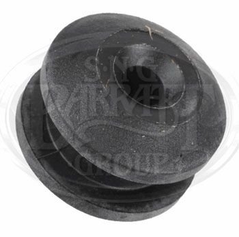

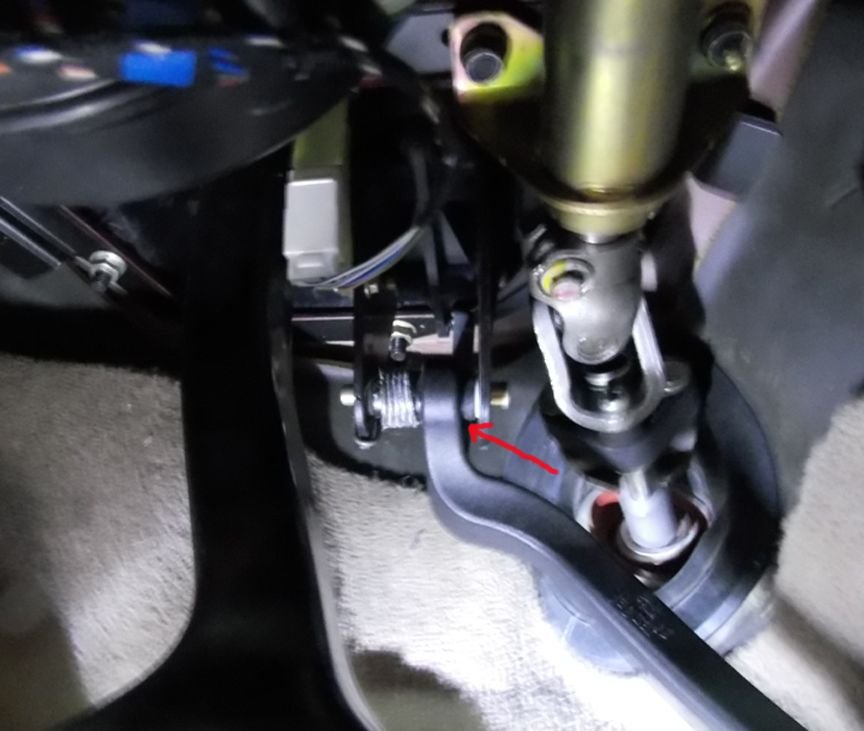

There is no ball & socket between #1 and #4. Part #4 is a rubber grommet that appears to be sitting inside the bush-like end of the pedal and it rides over the steel pin. Part #4:
The pedal seems to be NLA so you need to look for it on Ebay or junk yards. You can see attachment of the pedal on the pics on Ebay - Jaguar XJ X308 2000 Vanden Plas Accelerator throttle pedal MNE5372AB PUM13271 | eBay and 98-03 Jaguar X350 XJ8 Vanden Plas Accelerator Brake Gas Pedal Assembly OEM | eBay.
