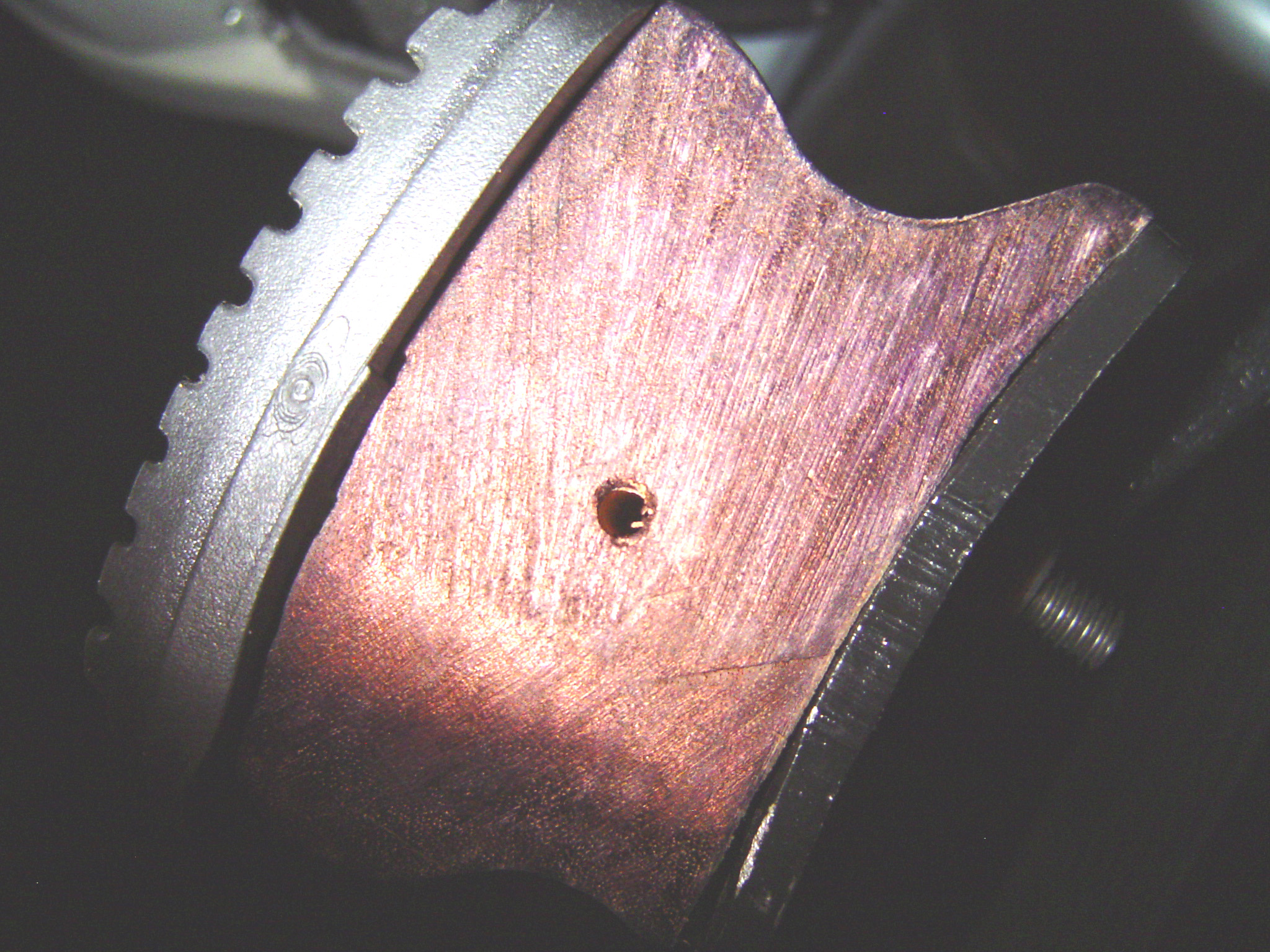

My solution was to extend both pedals and the footrest back by two inches. The footrest was done by inserting a couple of lengths of pipe of the right diameter into the existing two large diameter plug/sockets. For the brake pedal, I bolted a suitably dimensioned block of hard wood to the pedal. This was topped off with a curved metal plate of the right thickness and shape to allow the original pedal rubber to fit over it. Finally for the throttle, I machined up a couple of suitable bits of aluminium with a pin on the lower one to replicate the bottom of the throttle lever and the top one suitably shaped to clip into the plastic pedal face. Hopefully the photos will make all this clearer!!
