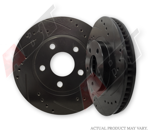

hi sean,
if I had known i would have purchased the 355mm. I have 325mm I purchased off of Ebay about 6 weeks ago. Part-SS-BZ-20015 What do you recommend for calipers? Do you have Part #'s? Thanks again for the reply! Manufacturer Part Number: SS-BZ 20015Manufacturer Part Number: SS-BZ 20015
I have Name:  ssbzrotorbig-1.png
