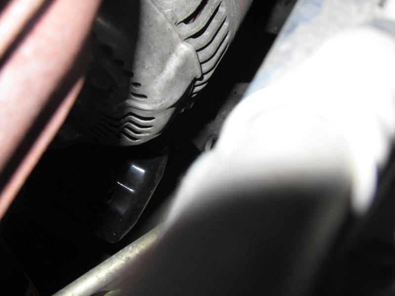

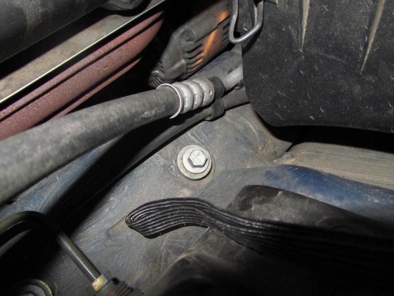

The next 3 Photos show the location of the Engine Oil Filter and Engine Oil Pan Drain Plug:
Here is photo of the engine oil drain plug and oil filter located next to the passenger side front wheel (2001 XJ8) taken from under the car - the oil filter has red lettering on it (Bosch) you can see o and the s:
https://www.jaguarforums.com/forum/a...tion-photo-jpg
Here is top view photos - first one is the alternator and the oil filter taken from the top of the engine compartment near the middle of the valve (cam) cover - the oil filter is just below the alternator
Second one shows part of the engine valve cover and the alternator (I have a flashlight shining on the alternator from below it).
Jim Lombardi
